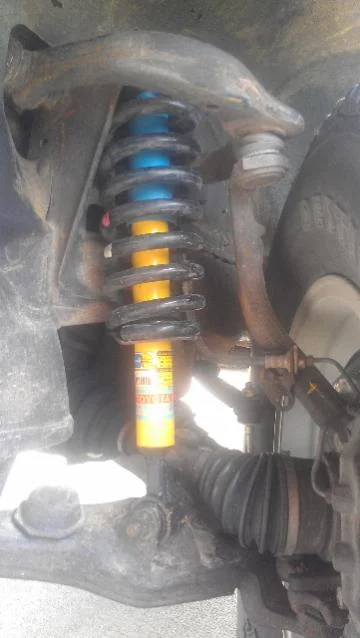

Oh, and luckily for you I have replacement boots when your's tear, those CV angles look really bad. Are they the originals?
I have recently replaced the cv boots. I'm sure they wont last long at that angle!

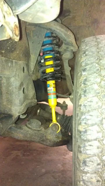

My plan is to shorten the rod on the bottom of the strut by 1" and see if that is where I need to be. I got some 5/8 id tube that I can sleeve over the rod on the strut, so it should be plenty strong.
The spacer/lift ratio on my 1st gen Tacoma is almost a 1 to 2. 1" of spacer nets around 2" of lift. Geometry of the upper/lower control arms, spring age/rates, bushing conditions, etc. have some factors too. I'm no mathmatologist so I just stick with 1-2.

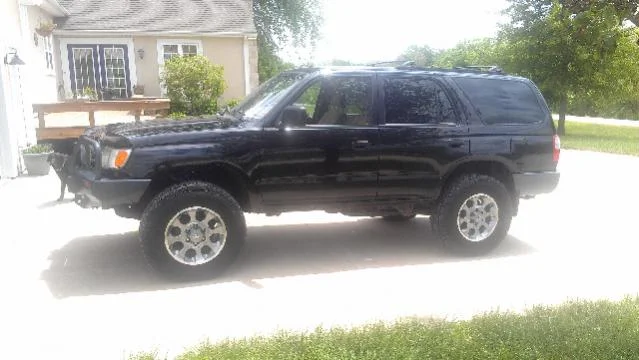

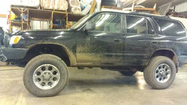

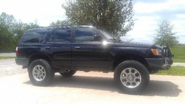

I ended up shortening the lower shaft on the front strut by 1". I sleeved and welded it all back together. I'm running 2000 v6 stock springs front and rear. There's a 3" spacer on the rear for now.
It drives and handles great on the road - haven't been on the trails yet. Running 285/70R17's on stock fjc wheels with no rubbing.
