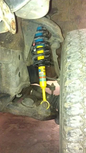

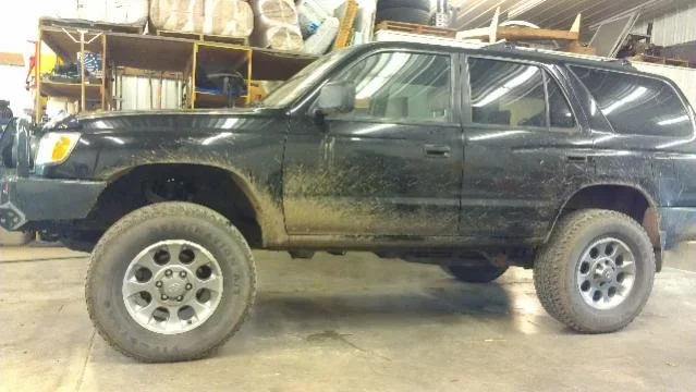

Hey Jason! I installed them yesterday, but with stock 2000 v6 4runner springs. I haven't driven it yet,, but it does appear to have considerable lift. Should I have used the 2011 taco springs? They were slightly taller with larger diameter coils. Now I'm looking for some 80 series front coils to lift the rear of the 'runner.
Ok, so I finally drove it last night and I'm not at all pleased. At 50+ mph I can feel a high speed vibration in the front and the bump steer is horrible. I think the lift is too much. I measured 24.5" from wheel center to fender opening. I didn't take a measurement with the old setup so I have no point of reference. I think I'll lower it some and see how it works.
Hmm, I wondered, as the ones that have done it had V6s, heavy skids, and bumpers. Plus your coils are probably worn out, but the tacoma ones will make it ride like it's on pogo sticks. Not to rub salt in the wound... but you get what you pay for :flipoff2:
Don't forget, have to get an alignment soon afterwards. At this point you'd be better off running a spacer and waiting for some adjustables. Better yet, just get some adjustables and be done. All the time, money, and time spent jacking with it... you'll thank me later. Let me know if you need help, I'll be around
