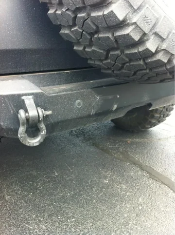

I'm not seeing any structural support offered from the frame rails, short of the body mount bracket, which could remain and be gusseted, or new fabbed.
I was starting to think about boxing the frame rails, using the sway bar housing as the crossmember, welding recovery tabs inside the cut rear rails.
Then building a bumper out of 1/8", and reinforcing with substructure. At the wings go 3/16 with a tie back to the frame where I'll be cutting the rear fender, if it cuts, and tie into the lower, tapered rails.
I've no need for swing out, or swing down, since the goal is to keep it lean.
All this sounded like a really good idea, until I was rear ended in the FJC by a BMW a few hours ago.
Considering the difference in the height of the FJC and the estimated height of the LX with the 4" slinkies, he might've just wound up bouncing off the tires, but I guess I've little option but to consider this as a potential occurrence.
