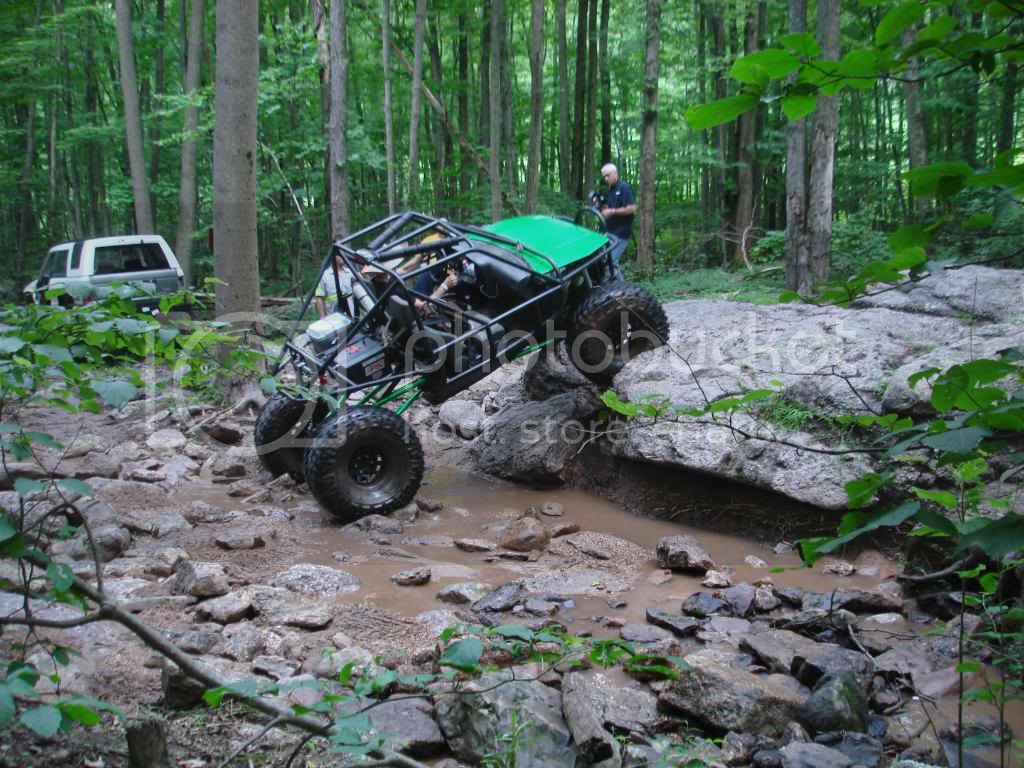

engine 94-pickup-22re
trans-94-pickup- 5speed
t-case-doubler 2.8
front axle-fj40 with longfields
fear axle-94 ifs pickup, stock shafts
r&p, yukon 5.29 f&r
locker- welded f&r
ben wheeling this buggy on the rocks whole year with the 39" mickey thompson baja claws of my landcruiser, they weigh about 140lb each (with rim) the 42 rockers are about 10 lb less than baja claws. never broke anything with those heavy tires, and they get good traction to, so i would think that lighter tire will put less stress on the axle.

Other than the "yukon 5.29 rear R&P", I'd run it. :grinpimp:
I and many I know have had bad "luck" with them. I never blew a set up while hammering on them off road...but all three sets I destroyed literally crumbled. they would get a weird texture, then would begin to chip apart over time. A friend of mine had the same thing happen to him a couple years earlier.
