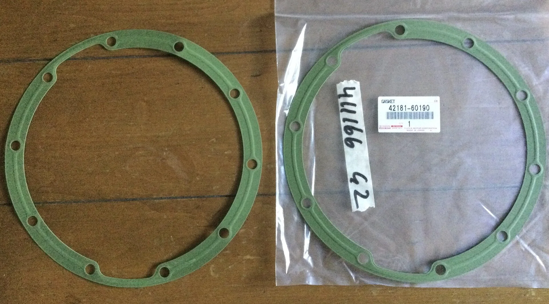

Tundra and 300 (right side) have the same differential gasket, this is despite the part numbers being different.
