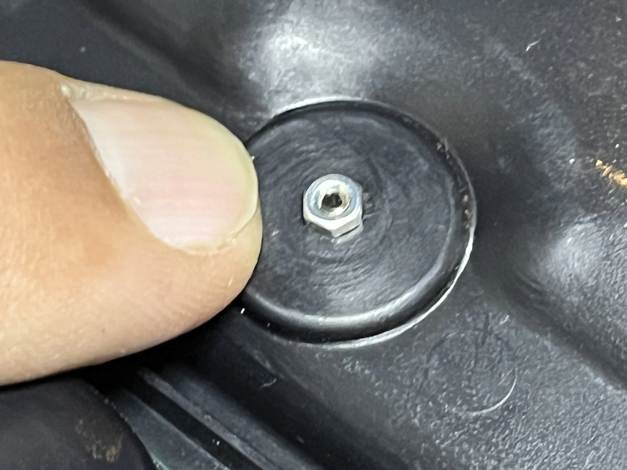

Went to local hardware store (Menards) and miraculously found a nut small enough. Used dab of thread lock on the threads to hold it in place so hopefully it won’t work its way free again. Also dabbed the other setback holder magnet threads with thread lock.
New nut installed and magnet in place. So tiny.
M2x0.4 nut

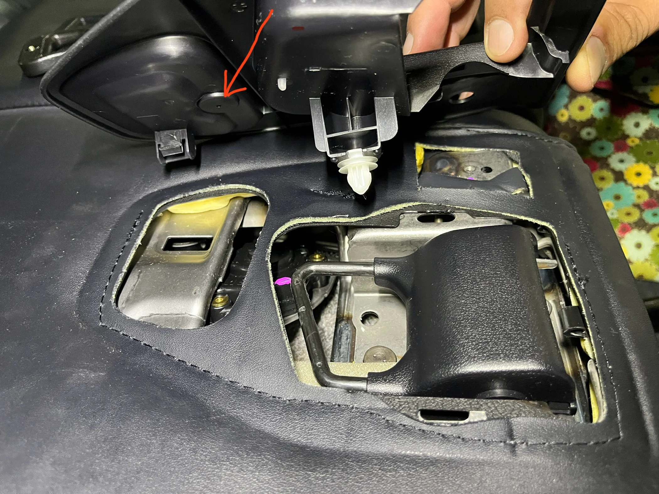

Plastic cover removed from seat back.
Need to remove small rubber bumper first, then the trim piece is held in place with two clips.
Red arrow is where the nut would be.
Lower right of frame is the steel hook that secures seat to the D-pillar.
