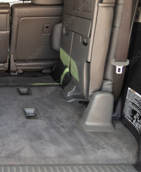

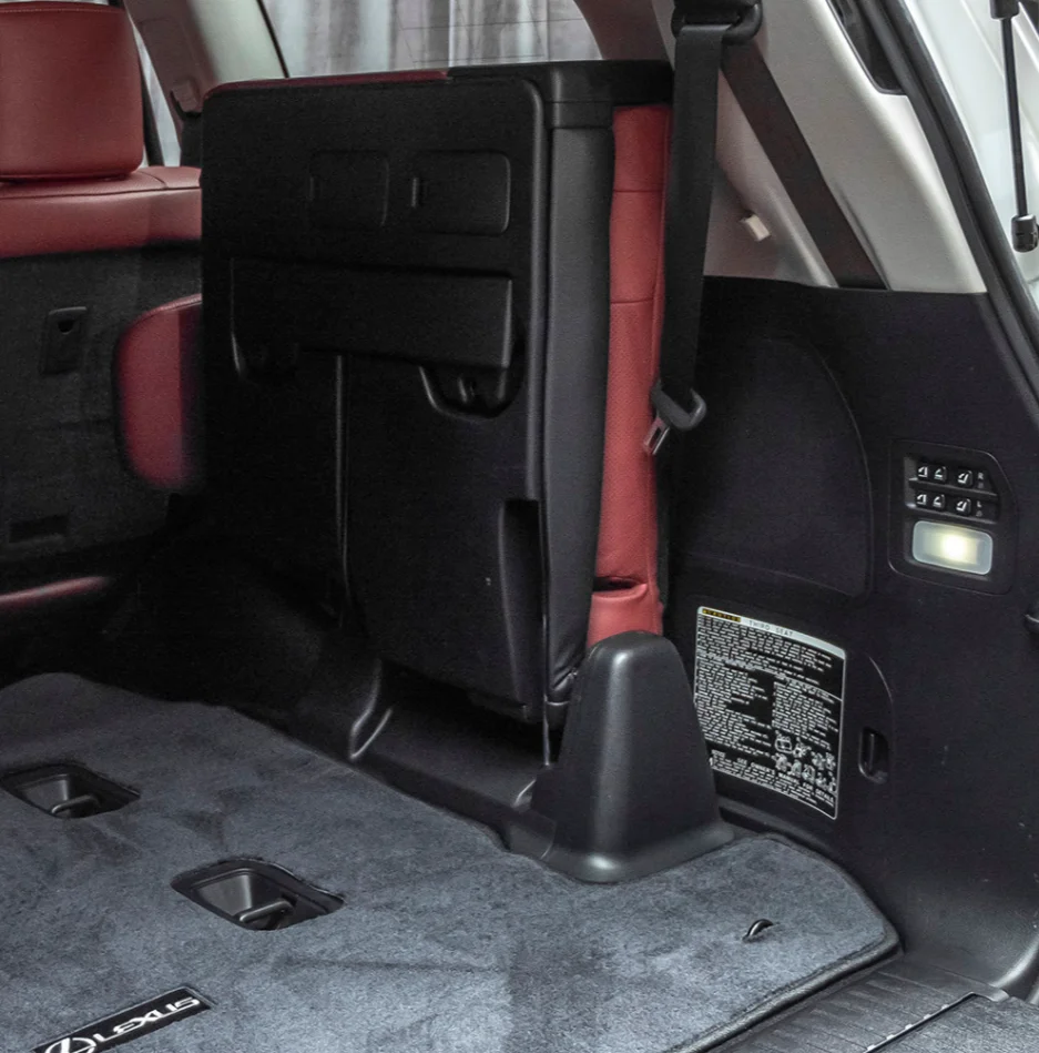

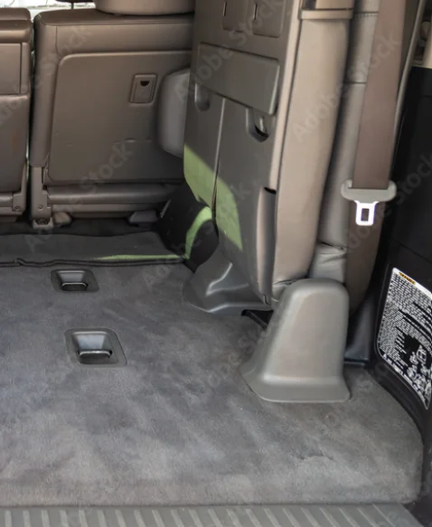

From pictures it looks similar (LC200 left, LX570 right) yet different in some of the details as well (e.g. the way the side cover and cover around the seat hinge is more "integrated" in the LX570 and there is a lever mechanism for the auto function on the LX570).
I would think you need LX570 specific seats and probably 16+ LX570 version.
