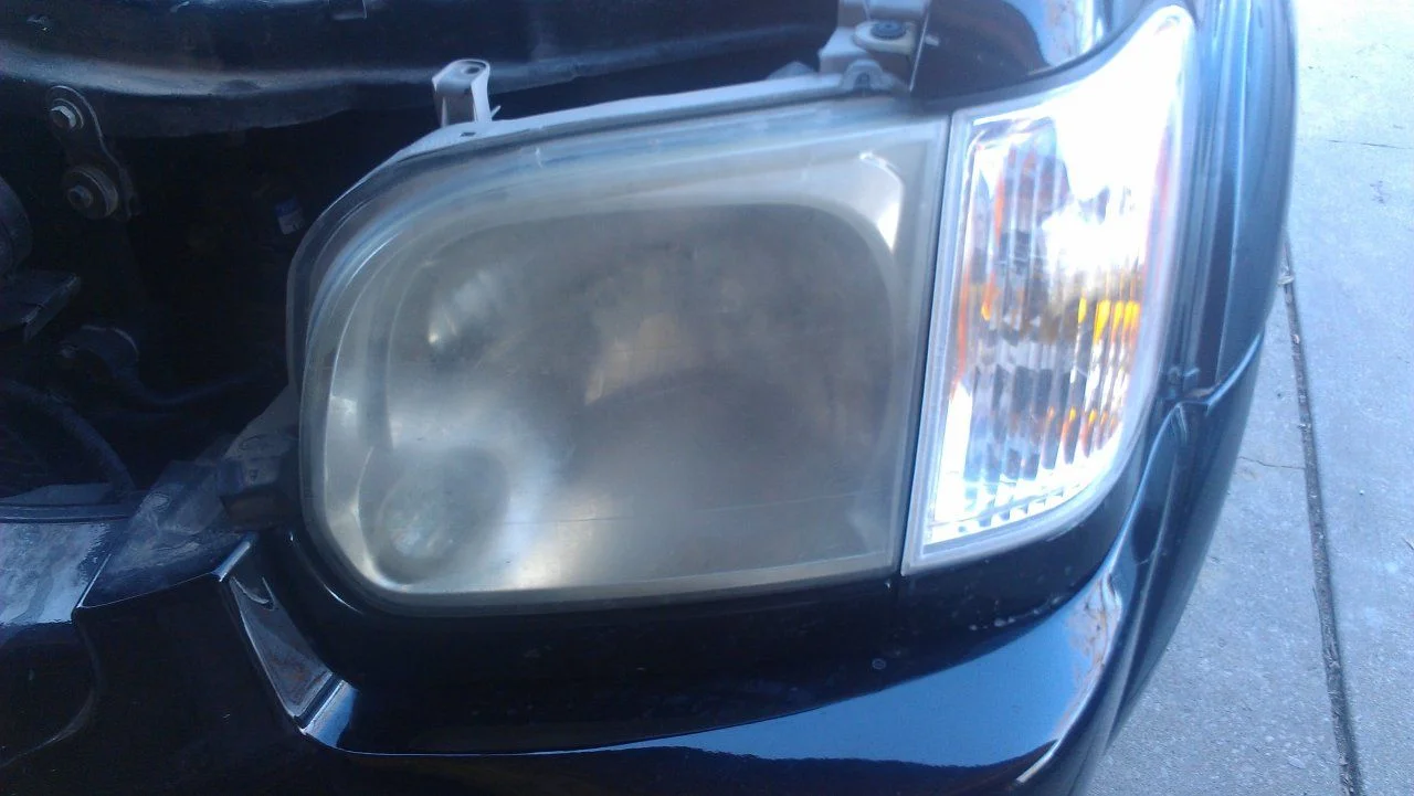

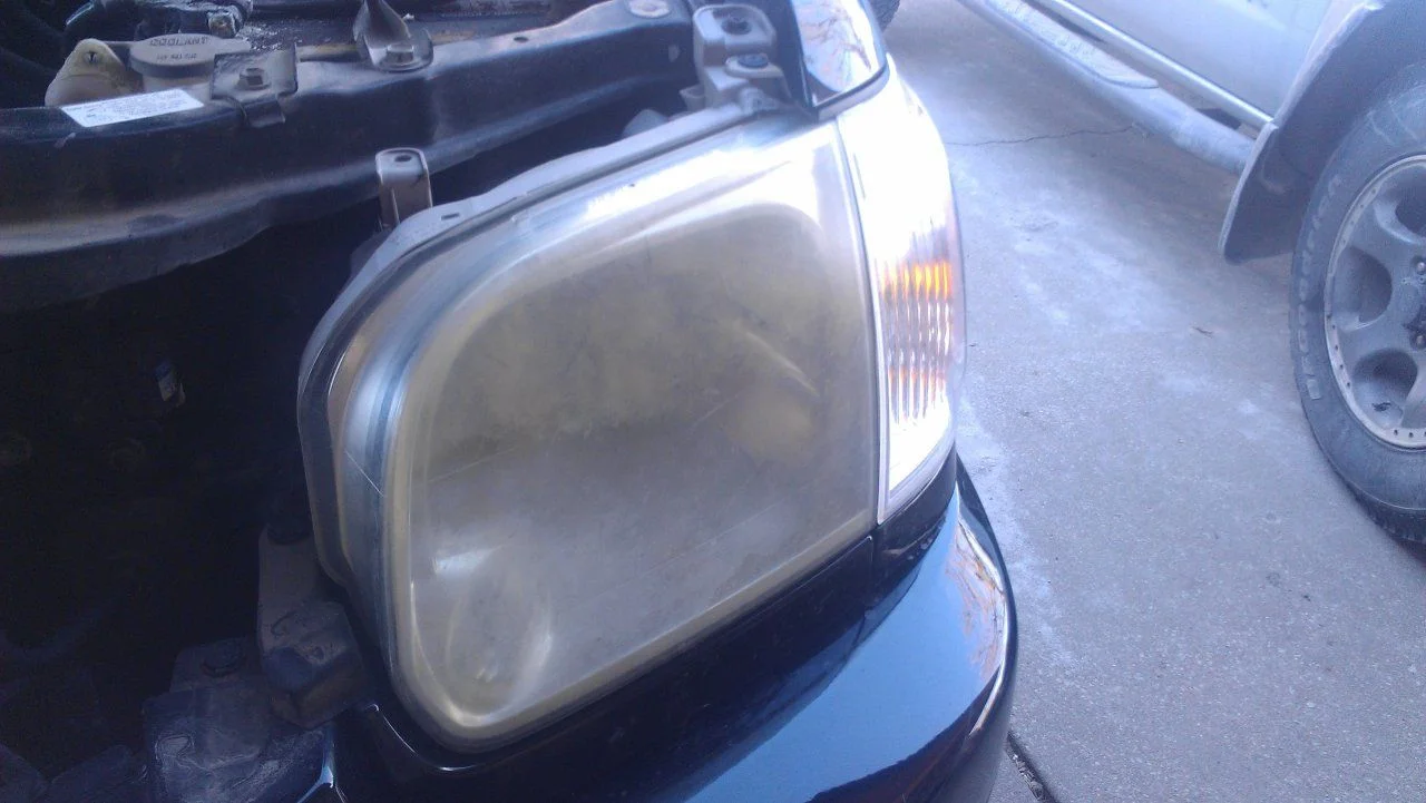

My wife's 2005 Sequoia is/was just such an example. Here are some before pics:

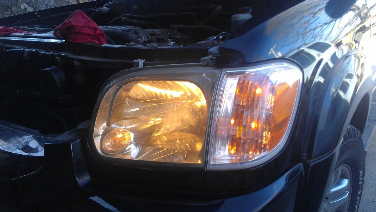

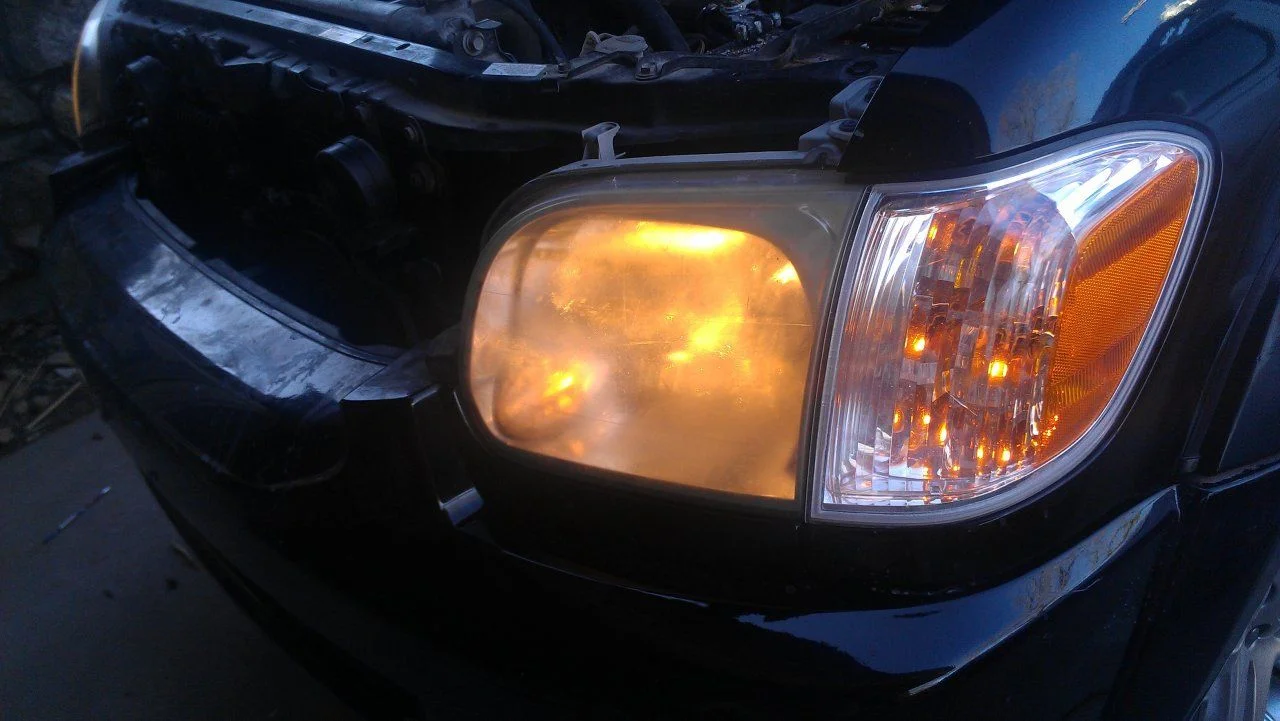

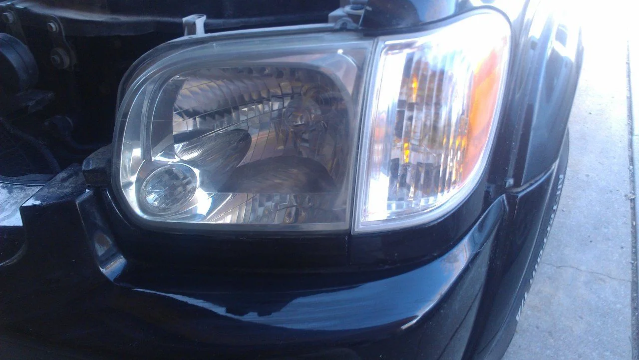

After pics:
Conclusion: I'm not ready to call them as good as new, but those lenses look a damn sight better now than they did. I'll call it good for $15.
The over all light output didn't seem to improve as much as I had hoped though. I think it's time to look for some different bulbs now.
