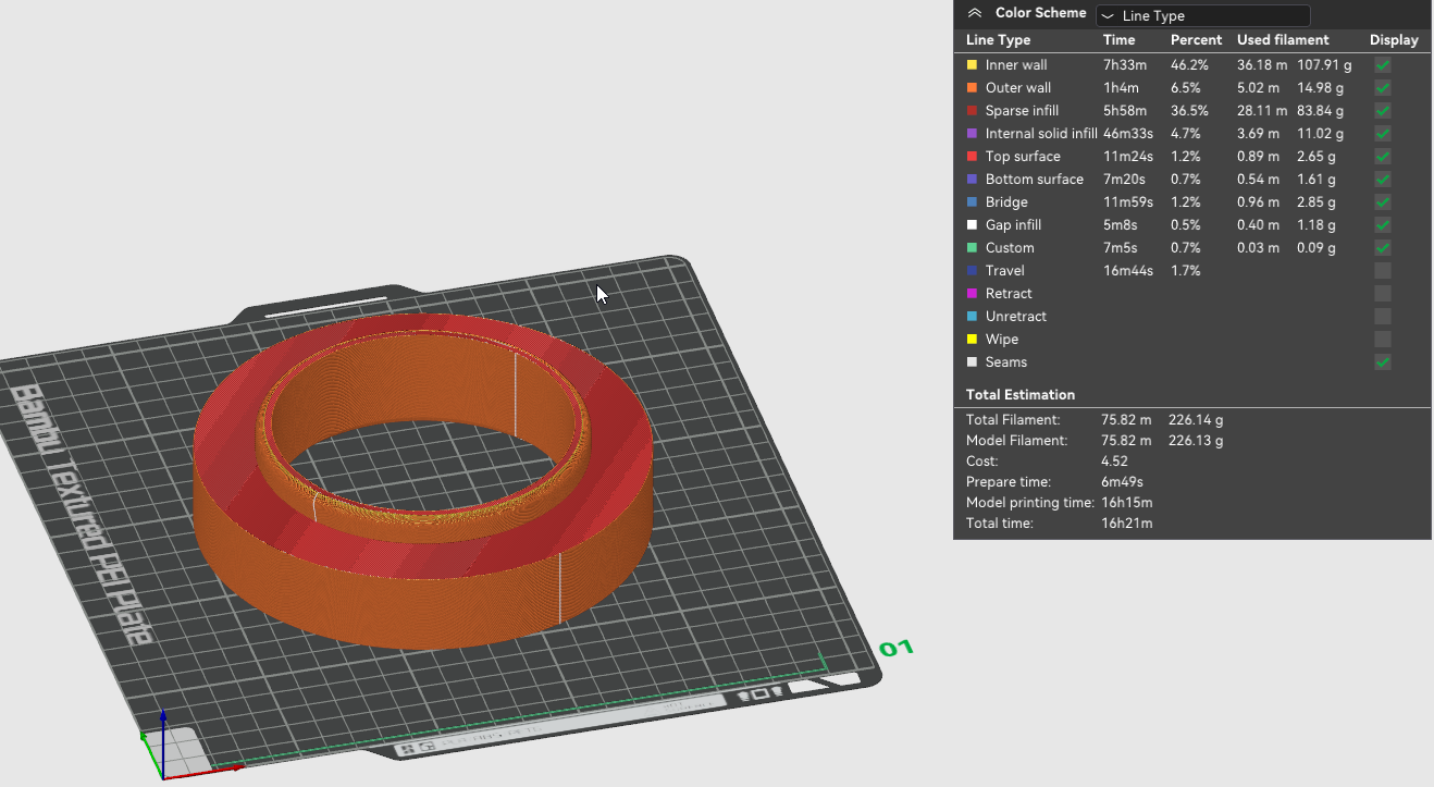

Roughly modeled; Apparently I've forgotten how slow TPU is to print (0.4 nozzle at 0.2 layer height, 8 walls, 90% infill)
edit: changed out the stupid infill pattern I thought would be good to something more reasonable. Much better overall time!
Uses almost 1/4 of a roll of filament, at $54 a roll, ends up costing (via a 3D printing calculator tool), close to $20 for one piece.
