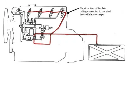

Furthermore - There is a check valve (non-return valve) beneath the primer pump (but not part of it) that should prevent your fuel running back to your tank. - So I think you have another problem ---- most likely a leak your "injector bleed line".
A common place for leaks in the bleed line is that short piece of small-bore tubing arrowed in the pic above.
But leaks in any part of the red section often allow air to be sucked in without you seeing any diesel leaking out .... so consequently they can be hard to identify/locate.
:beer:
PS. Best way to check for leaks is to use air pressure to pressurise your tank and stuff "facial tissues" around suspect areas. (When tissues get damp with diesel - you've found your leak.)

Lostmarbles...thanks for the tip. I'd already used the same diagram that you had posted for someone else to find a previous leak in that return line. I'll add the tissue test, though, that's a great trick.
