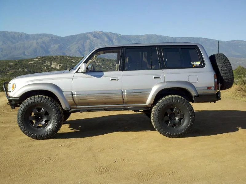

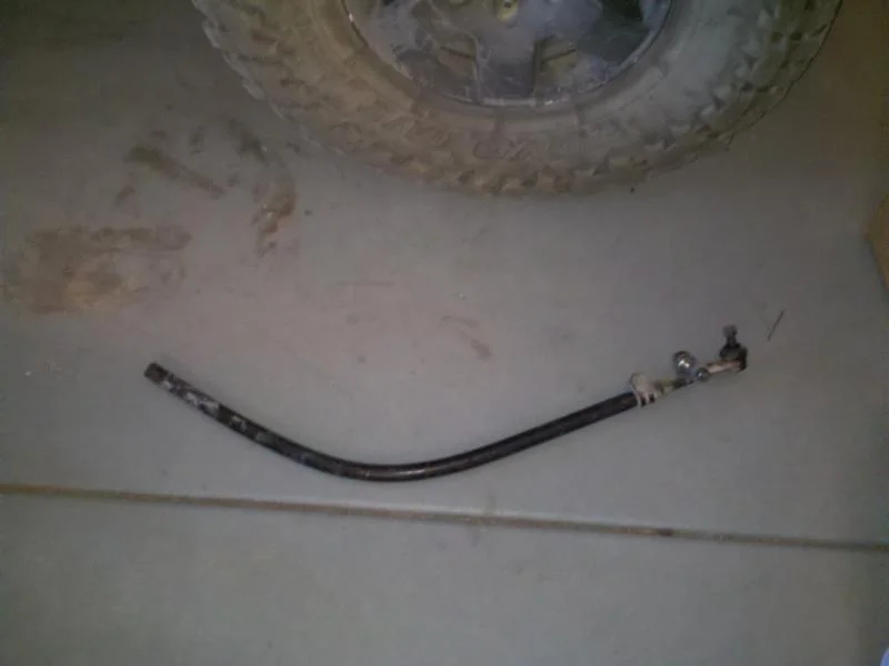

Been wanting 37s for awhile and finally pulled the trigger. Tested them out this past weekend up at Big Bear. Ran John Bull and Gold Mtn in both directions and also did Dishpan springs. Now I have a few mods to do to accomodate these things. I knew I was going to swap out my 1.5" spacers for 1". Ordered the 1" today. Also found out the heavy Toyos require a lot of strength to turn in the rocks. Taco'd my relay rod right smack dab in the middle of the waterfall at dishpan springs (see pic). Today I ordered both a stout tie & relay rod from Budbuilt. Luckily there was another 80 series in my group (80BajaBound) so I removed his relay rod and used it to get down the trail. One of the guys with a Jeep Cherokee had a sleeved spare that fit my 80 and saved my day. The gears are next on my list. On road is fine but there were a couple of difficult lines I took on they trail that proved too much for stock gears. Had the pedal to the floor and it just wouldn't go. In addition to adding 1" wheel spacers to help the rubbing issue, I thinking I will add a 1" body lift and lengthen the bump stops.
On a positive note, the extra clearance and bigger tire circumference was a huge plus for me while in the rocks. I drug my diffs much less than in the past.
What he forgot to mention was the mcguyver act his buddies performed to straighten out the tie rod from the day before. Turns out an arb bumper, d ring, vice grips and a winch can straighten out a taco'd rod at camp or on the trail. We did dishpan both ways and up it was awesome!
I was out there just this Sat and did not see another 80, you guys must have been at the springs. That was a bummer with the relay rod, I've seen it happen, but not as bent as that...I'm with you on the steering, contemplating on hydro assist mod. I was with a mud member DUSTY, he mentioned that you really need it once you go beyond 37's. At 37's its nice, but keep it as is, steering response with it on the road lags. Let me know how the budbuild work for you.

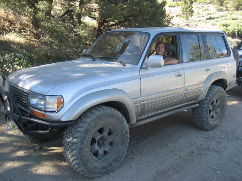

I was too busy wheelin' and having fun to take pics this time but here's a couple my daughter took. And speaking of my daughter, I let her run Gold Mountain as her first trail run. ( P.S. she is taking her driving test today at the DMV:steer:)

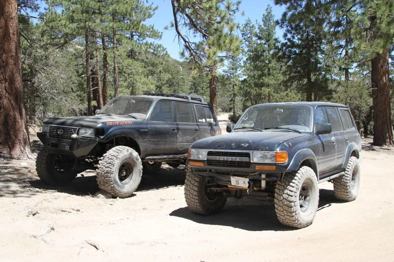

Mike doing some 3 wheel action, me wrenching on the trail, and my daughter just after we finished Gold Mountain:
your rig looks great on the 37s. Also the two rigs in the other shots look good too. It is nice to see them out on the trail. When I had mine up in Big Bear I never once saw another 80. Seeing two built like the ones posted would have made me think I was hallucinating.
