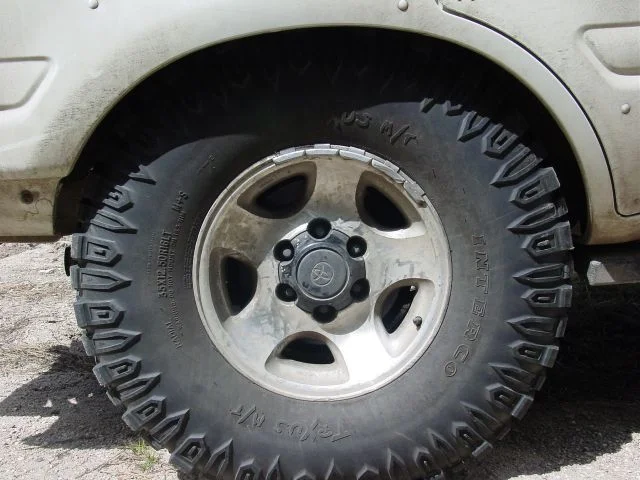

This is what a 35" trxus looks like at full stuff on my lift without flares. Ton of room for an additional inch of diameter - it's the the 13.5" width that may cause the issue. If trxus MT's ever come out in a 36x12.5x16 I don't see how I'll resist given I already have more than enough gearing...
