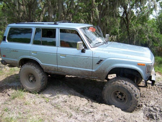

You can see from the pic below that my SOA is pretty low:

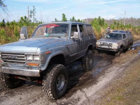

SOA is the best way to go, for all reasons he just mentioned...$$$, articulation, clearance (SUA will catch rocks and obstacles that the axle would normally just slide over with SOA).
Those are 37s, I've driven it with a set of 39.5s before, on a rim with major backspacing...but they cleared for pavement and steering...that was right after my lift, which was a total of 12 1/2", but I've lost almost 2" since then bcuz we rearched the springs.
My FJ62 still clears 38.5s with no rub and 5 folks in the cabin. This may be beyond what most cruiser folk want, but just making the point of SOA.

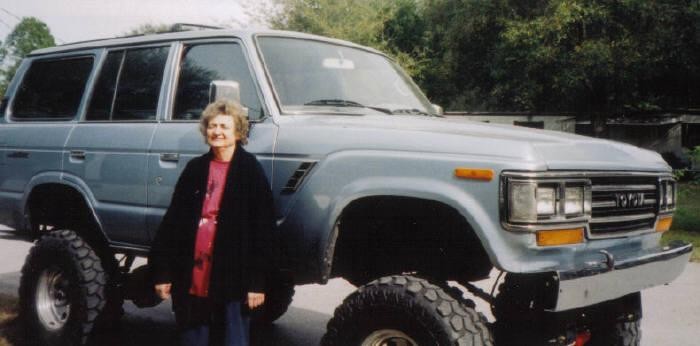

since it's all about clearance for the moment, here's a pic of my lift right after completion with my 33X12.50s!!! Then a recent pic, in which I now have 38" Swamper TSLs on the rear, neither rub /hit even when loaded down (we had 7 passengers in the ONF just two months ago).
Oh yeah, that's my Gma next to the cruiser! lol
