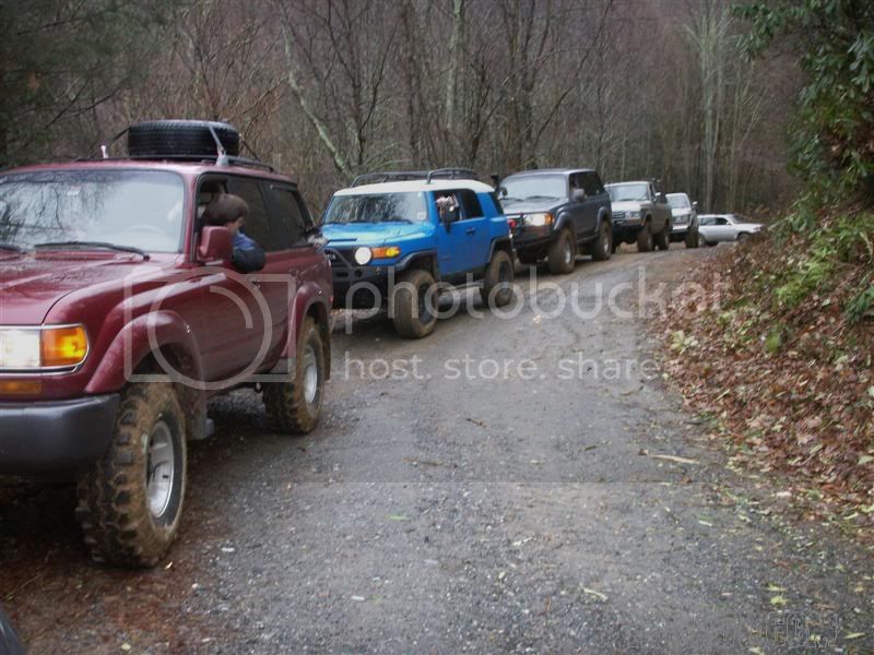

the Q78's end up being 35.5 x 10.8 according to interco's website. here they are on the red 80 w/ a 2.5'' lift.
checking for rub, none.
