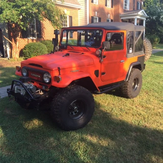

Here is mine on 35's love them
Thanks that makes a question all these years answered
I'm certainly no expert, but I have gone through just about every stage of lift and this just looks like my 4" lift on 35s did.
I just found another pic of what I think is your truck and it confirms my guess. Those rear springs have lots of arch and the shackles are not that long.
The top of the tire is just about even with the top of the arched part of the frame, which is my at a glance check. If it were a 35 on less than a 35, the frame would be lower.

So this tells me there is no way 35's are going under a 2.5" lift.
Looks like OME 2.5" on 33 12.5 15's......now which tires?
