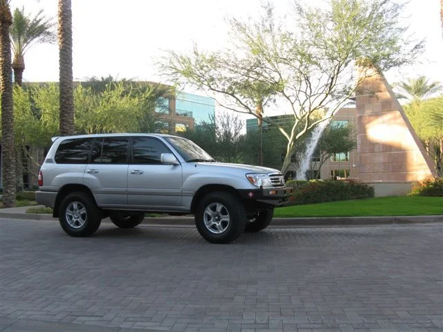

Here's my 1999
No body lift or bump stop extensions... for now..
Minor rubbing in rear inner wheel wells.
I'd recommend regearing your t-case at a minimum if you go with larger tires.

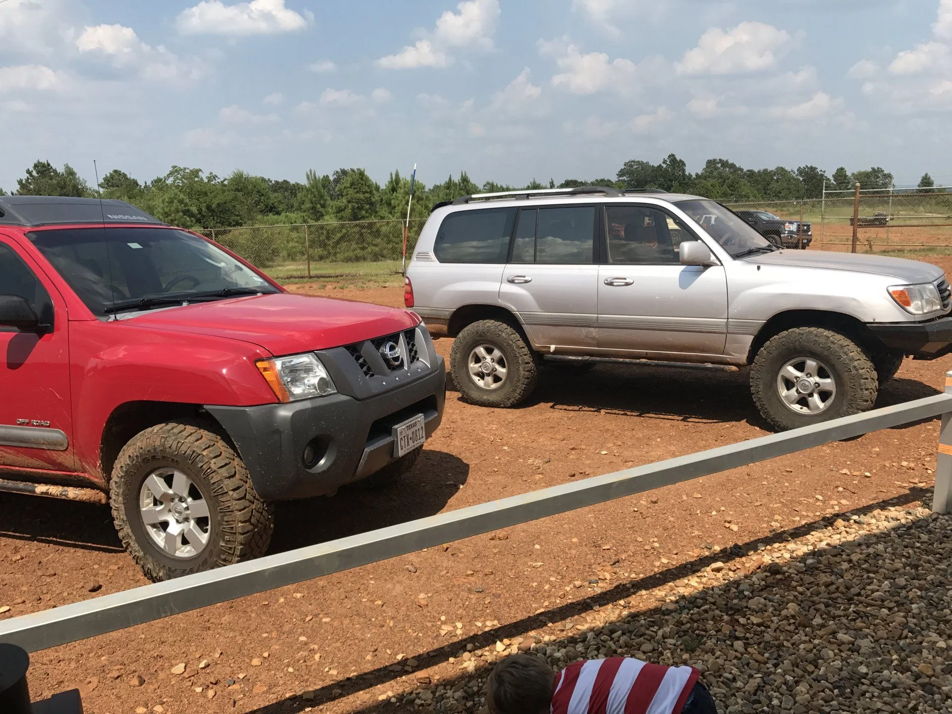

I ran 315s on my IFS 1999 UJZ100 on stock suspension for several months.
The same set of tires was run for several months on our LX450 when it was bone stock.
The particular tire is a 315/75R16 Fierce Attitude MT.
I beat the pinchweld flat and trimmed the plastic fender liner where it was rubbing.
You'll have to see if you can find tires that will fit. They are not all exactly the same size.
Mine run in the rear inside the ribbed sheetmetal above the frame rail. The rubbing is minimal and doesn't cause any concern. 2" bump stock extensions would fix that.

The tire size is supposed to be a 34.6"
I can say without a doubt that particular tire will fit on an IFS rig with minor rubbing until it can be lifted.
They barely clear the UCAs but also tuck in the wheel wells when flexed.
You can crank the stock torsion bars a little bit to help clear them up front.

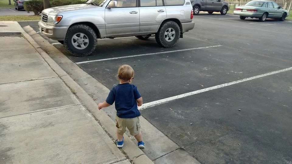

Here's a pic with them on my 1999 on stock IFS suspension.
I had "35s" (34.6" to be exact) and I dropped down to "33s" (33.54") trail grapplers. 295/70/r17. I was on 295/70/r18 Cooper STT Pros before.
I had to trim inner fender, hammer down pinch weld and had the front lifted more than it should (caused bump steer and torque steer and alignment couldn't get in spec) because I didn't have body lift in yet. I was going to lower the lift a tad and put in a body lift to account for it. But then you need to deal with relocating your radiator and adjusting your steering linkage.
The 35s were the straw that broke the camels back for my rack and pinion and I had to replace that.
SOO....it can be done but is it worth it? Not in my opinion. A lot of work and money for an extra half in inch in real clearance? No thanks. Plus I wanted to still be able to fit in my garage with a light bar on top.
These rigs just weren't designed and engineered for 35s. Just ask Slee. He thinks putting 35s under a 100 "is crazy."
33.5-34" is a sweet spot on 100's nearly all the benefit of a 35, without sliding down the slippery (and expensive) slope to get there.
