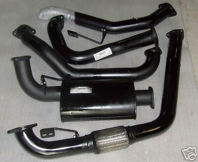

Looks like I might have found an off the shelf over the frame solution.. It is really for a HDJ80
http://www.rage.co.nz/bigbore/toyota41-43.pdf
Well mostly off the shelf. The downpipe will need to be mated to the stock collector for those keepin stock stuff up front.. Others can fab in downey tri-ys. Personally I will end up connecting it to a custom dump pipe fed by a seperate 38mm wastegate and a turbo..
I like the flex section.. Prevents a bunch of movement from the engine to be transfered into the pipe. I assume it helps keep things from banging with 3" going up and over the frame.
I found a northern north america distributor thru the MFG who I contacted. In AU shops converted to USD they are very reasonable $425-$450. Hopefully geting a few people on board at once will help control shipping.
the flex section is where the cat goes. Looks real good if it installs as advertised.
If so I would put a flex back in maybe on the downward leg from the engine.
I have seen how much movement they isolate on my turbo AWD car I used to have. Think some give instead of break or bend permenantly part like that is nice to have given the clearance there and off road pummeling.
Looks like a good potential solution (Mandrel is very nice) although that muffler may allow a good amount of noise. You can always switch it out for something else with more capacity.
I don't think the flex section is necessary. I had my header exhaust in place for a year when the rear mount broke loose. After that I put thick rubber washers in as insulators on all 3 mounts. No problems over the last 4 years other then when I crunched the exhaust under the frame and had to weld the torn front mount (before I went over the frame). Why add the turbulence if you can get around it?
