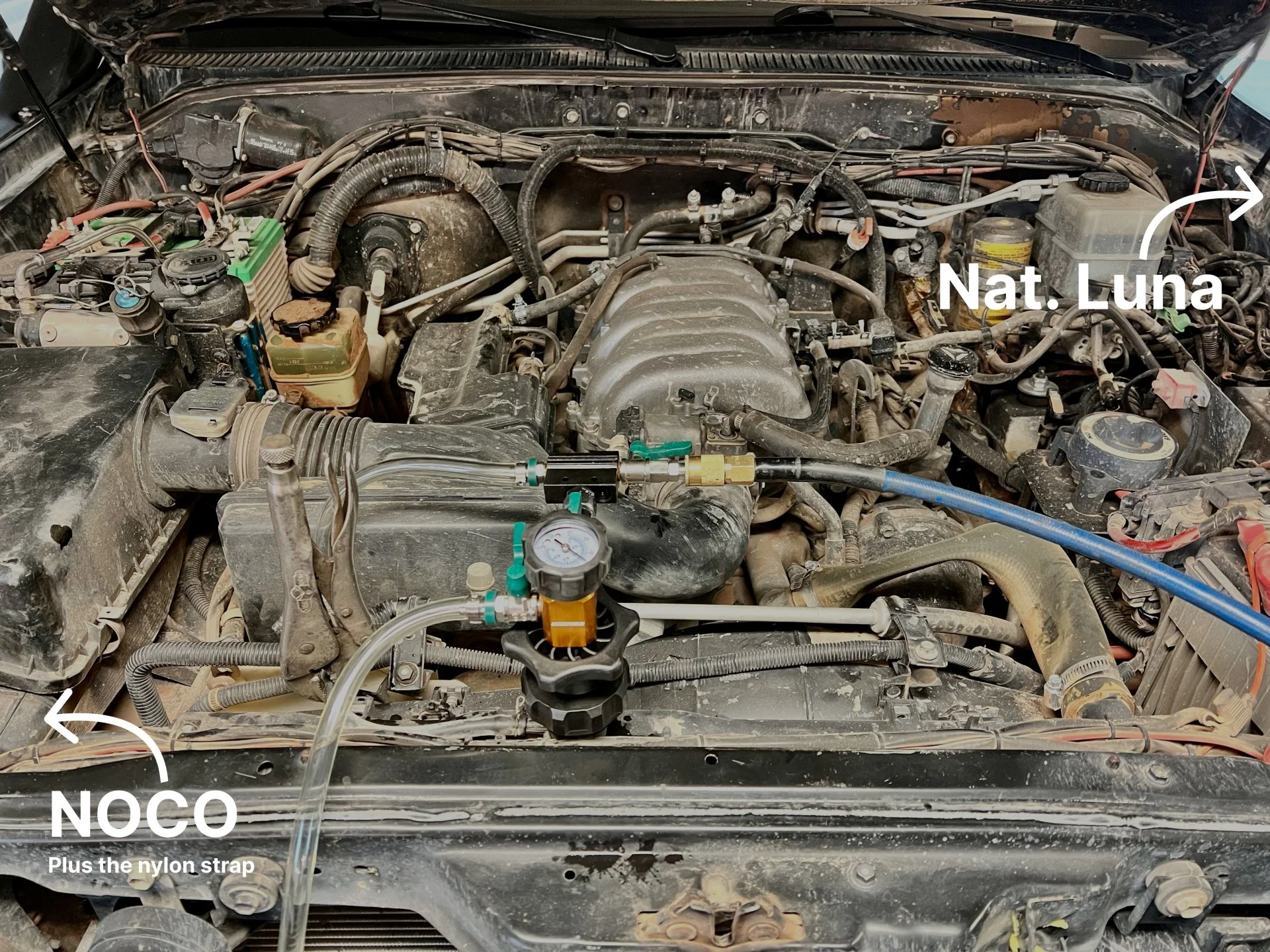

That's mostly how I run a similar setup. The second battery (under the hood) runs "house" tasks like the fridge and most of the charging equipment, and is isolated from the "truck" battery that handles the engine and any driving accessories. Lights, the winch, etc. The third (Bluetti, but similar to yours) is in the cargo area as just some extra power storage—charge the laptop, drone, etc., without having to have the car running. That way I'm not asking the house battery to charge a laptop and potentially draw it down enough that it can't keep the fridge running overnight.
I also have a 100W panel on the roof pushing charge into the house battery. I just went with Slee's recs on the second battery, and it's not large enough to keep a fridge going in a hot desert (in a black truck) for more than 8-9 hours. Being as it's super sunny here, 100W is more than enough, but you can't totally rely on it. I lived for a month in 2020 out of the truck at/near Olympic NP and probably saw one day of good sun. It also reduces the amount of usable roof rack space, so in that way it's a bit annoying.
The National Luna isolator is what I used under the hood, but there are several good options. Blue Sea, Redarc, etc. That'll top the batteries under the hood anytime you're moving.
Last, for long camps (or when I just feel like working with an ocean in view) I snagged a Noco dual charger and just strapped it between the airbox and the headlight. Noco also have a surface mount 120V plug wired I wired into the bumper. (Noco GENM2 and GCP1.)So solar, shore power, and alternator as sources. Complicated to do all at once, but I just built it a little at a time according to need.
Picture was from doing radiator work, ignore the hoses.
I also have a 100W panel on the roof pushing charge into the house battery. I just went with Slee's recs on the second battery, and it's not large enough to keep a fridge going in a hot desert (in a black truck) for more than 8-9 hours. Being as it's super sunny here, 100W is more than enough, but you can't totally rely on it. I lived for a month last year out of the truck at/near Olympic NP and probably saw one day of good sun. It also reduces the amount of usable roof rack space, so in that way it's a bit annoying.
