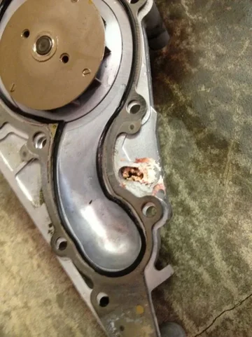

c) My pump at 94,600 was weeping, but it wasn't evident until you pulled the pump. There was a little bit of caked on crud on the outside, but it was more dirty than weepy. It wasn't exactly an operating room in there either. Nothing was damp. Wasn't until I pulled the pump that I saw all the red crystals on the inside weep hole passage. The weep hole indicates water has made it past the seal on the pump shaft. The passage provides an outlet for this water to go.
Here's the weeper.
