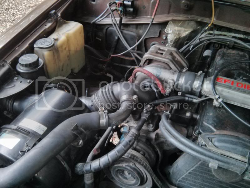

Thanks for the picture, but in my truck the crankcase vent pipe goes from the tube where it says EFI DIESEL to the rocker cover, is this wrong??
This is my engine bay:
EDIT: I am getting oil in the tube where it says EFI DIESEL!!
[/URL][/IMG]
That pipe should duck under the EFI pipe and come out and go into the rubber hose which is before the turbo inlet...
So the same concept as my photo just different locations
