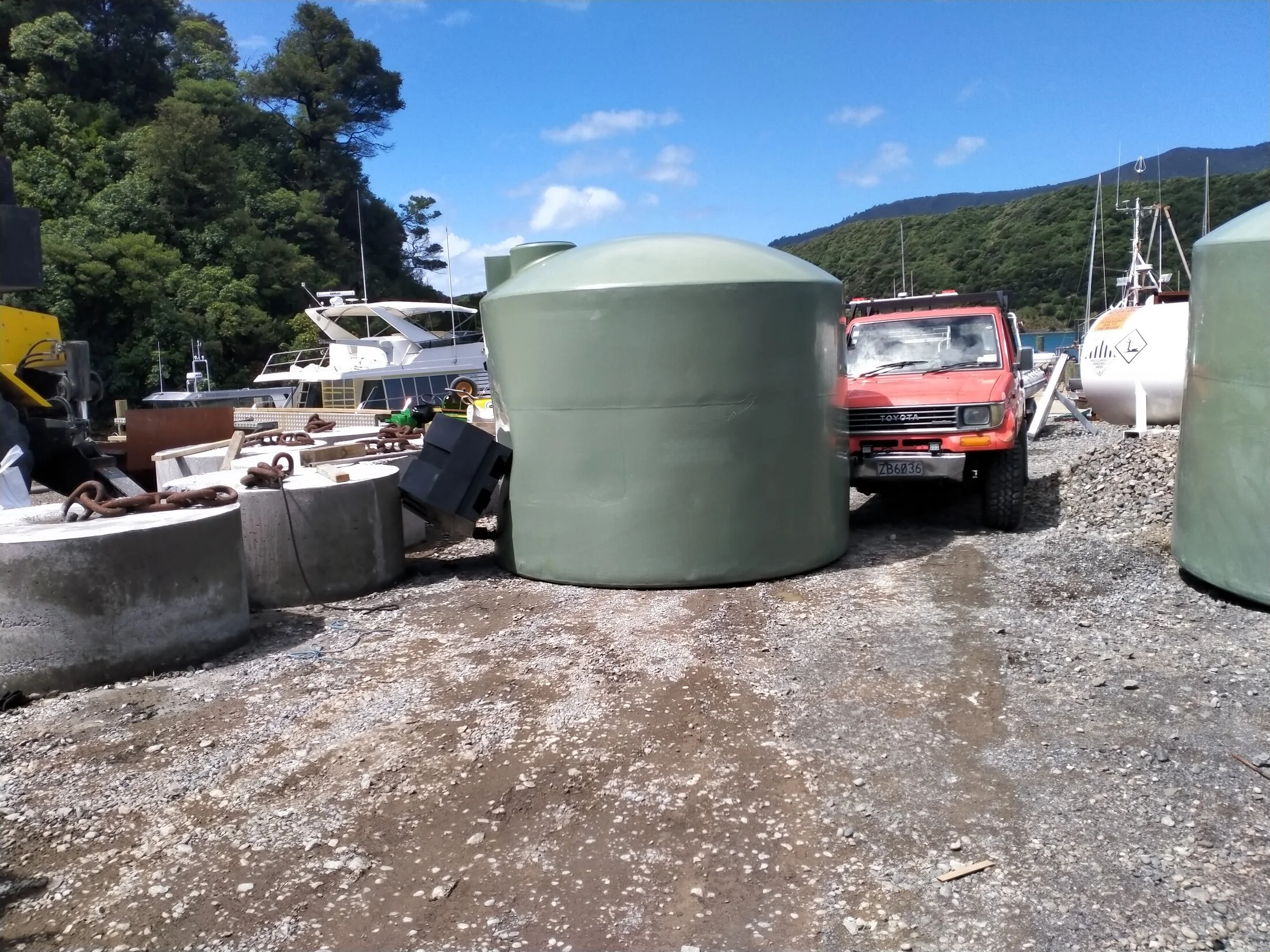

Have added a pic of truck, sorry it's the only photo I could find quickly, will try hunt down some others if anyone's interested, but like I said, she's just a workhorse at the moment, no trail beast
