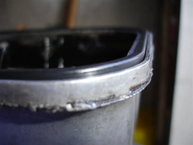

Here's the gasket on my B-engine valve cover...

I cheat and put a little gasket sealant on the valve cover to keep it attached, makes my life a little easier..
