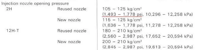

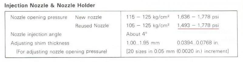

....The injector pressure pre rebuild we're 1100 psi and have been reset to 2130psi.......Buzz
Why 2130psi Buzz?
Aug 1980 2H FSM 36048E:
Nov 1985 2H FSM RM012E:
:beer:
I thought 2130 sounded a bit high for a 2H. All the more reason to be banging on the rebuilders door
Yes, that sounded way too high. I have a set that I will be putting in my Nissan that is 30 psi over factory. A bit over factory is suppose to give a bit better atomization and therefore assumed a better combustion. If I recall correctly, too high a breaking pressure will affect the IP timing and perhaps other problems in the IP, especially in a rotary IP .
