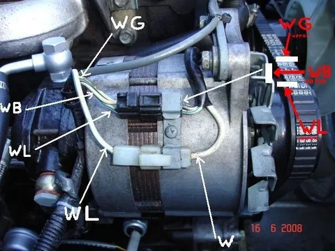

Hey Mate, you may can help.
My Alternator is not charging.
Those Lamps are on.
And the Altn. Regulator seems to be wrong meassures as well!? Do you know some tips for me? Thx a lot
Whats the thought if so? Lights are on?
When the charge light and filter light are on together, that can be a weak charge light relay. Often the lights will go out once you raise the RPM's a bit. On my HJ60 I have to rev the engine to about 1400 rpms to trip the relay which turns off the lights and starts charging the batteries.
Unfortun. Not the case. Even with rom up to 2ooo the rig dont charge :(
Here you can see my troubleshoot
