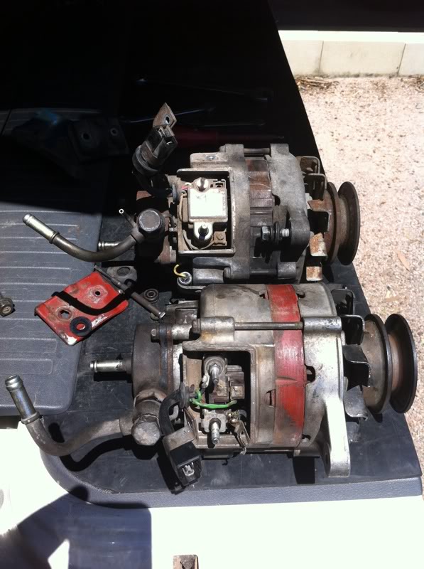

Ok, here's where I'm at. I got another alternator from a 2H in a 75 series ute, the mounts look to be similar if not the same, the plug is only slightly different. I just pulled the little top cover off both to see if swapping the plug from one to the other was feasible. What I found underneath looks way different - the new one is at the top of the photo, the old one at the bottom. Does this appear that the newer alternator is internally regulated and the old one isn't? If so, by disconnecting my old external regulator, will this make the swap straightforward?
Any help/advice is greatly appreciated!!!
old HJ60 alt are external regulated via V reg box in the drivers side fender ( LHD Cruisers )
Yep, mine's the same, but I am trying to bypass this external regulator and use the alternator with the internal regulator in it's place. I've got schematicsw for the HJ75 with internal reg and for the HJ60 with external reg and I'm trying to mash them together.....

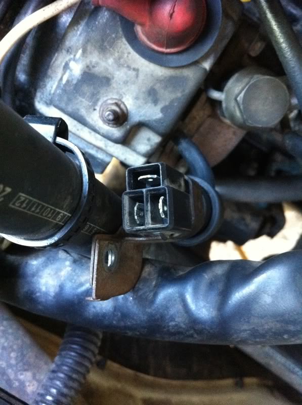

OK, looks like I've sorted it out. Thanks to the posts by Inventure in another thread, I've made an adaptor harness to go from the new alternator, bypass the external regulator and tap into the original harness again.

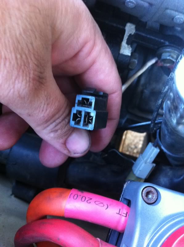

This is the older style connector off my original alternator

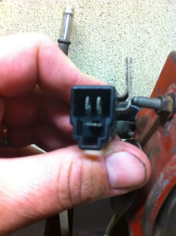

This is the connector off the new alternator...
This is the old wiring harness connector from the alternator...

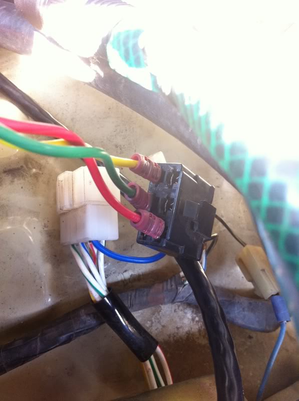

I ended up taking the connector off the new alternator and replacing it with a similar, but slightly more generic 3 pin plug that I could use with my adaptor harness, or plug back into an externally regulated alternator in the future if required. I used the pinouts from Inventure's post and double checked with a multimeter, made up a simple 3 wire harness with the same connector on the other end as the external regulator, crossed my fingers and gave it a shot....
Prior to fitting new connector....
End result appears to be a healthy 13.86v output back to the battery and no magic smoke coming out of anything so far. Took it for a drive to charge everything up and test with all lights and A/C running to see if it pulled the volts down. With the A/C running it definitely drops the volts on the voltmeter, but even with lights and spotties going as well, it still holds 12V.
Time will tell if anything is going to burn out prematurely or run the battery flat, but I'm hoping that it might be sorted for the time being.
For the record, Blue on the alt goes to Switched 12V (white with brown spots), Red goes to the Charge light circuit (black/yellow) and White goes to White.
If anything, I might upgrade the harness to include a heavier gauge wire to run where the White wire is now - mine is a little smaller than what was already in the harness, but I checked after my drive and it didn't seem to be getting hot, so maybe not an urgent fix...
