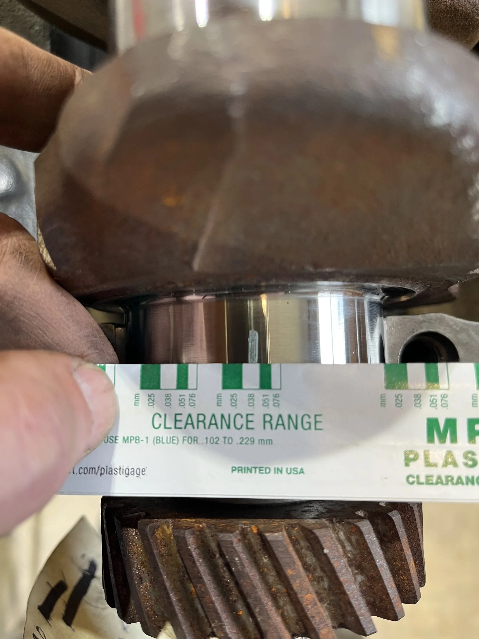

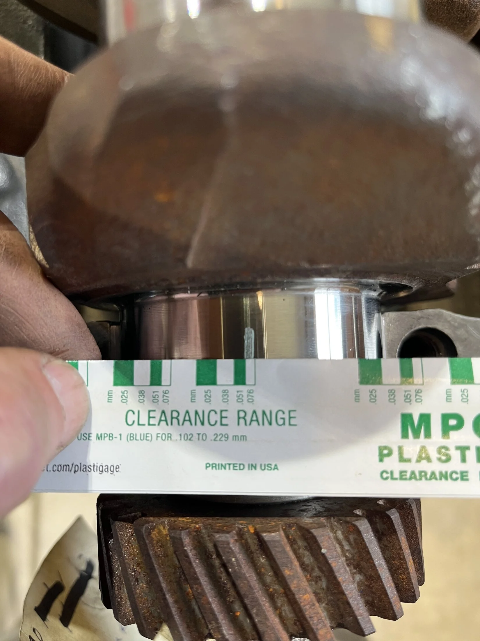

Between .051 and .076 main bearing clearance. Continue build or tighten it up a bit? Manual says .10mm limit! Crankshaft was milled 0.020 over so I purchased 0.020 over bearing. Looking like it may have already been milled .020 and another .020 was taken off. Would a .040 bearing get me where I need to be?

His measurement are in mm. 0.051mm = .002" 0.076mm=.0029"
To me, the plastigage looks like 0.076mm or 0.0029". which in my opinion seems loose. What's the manuals spec.

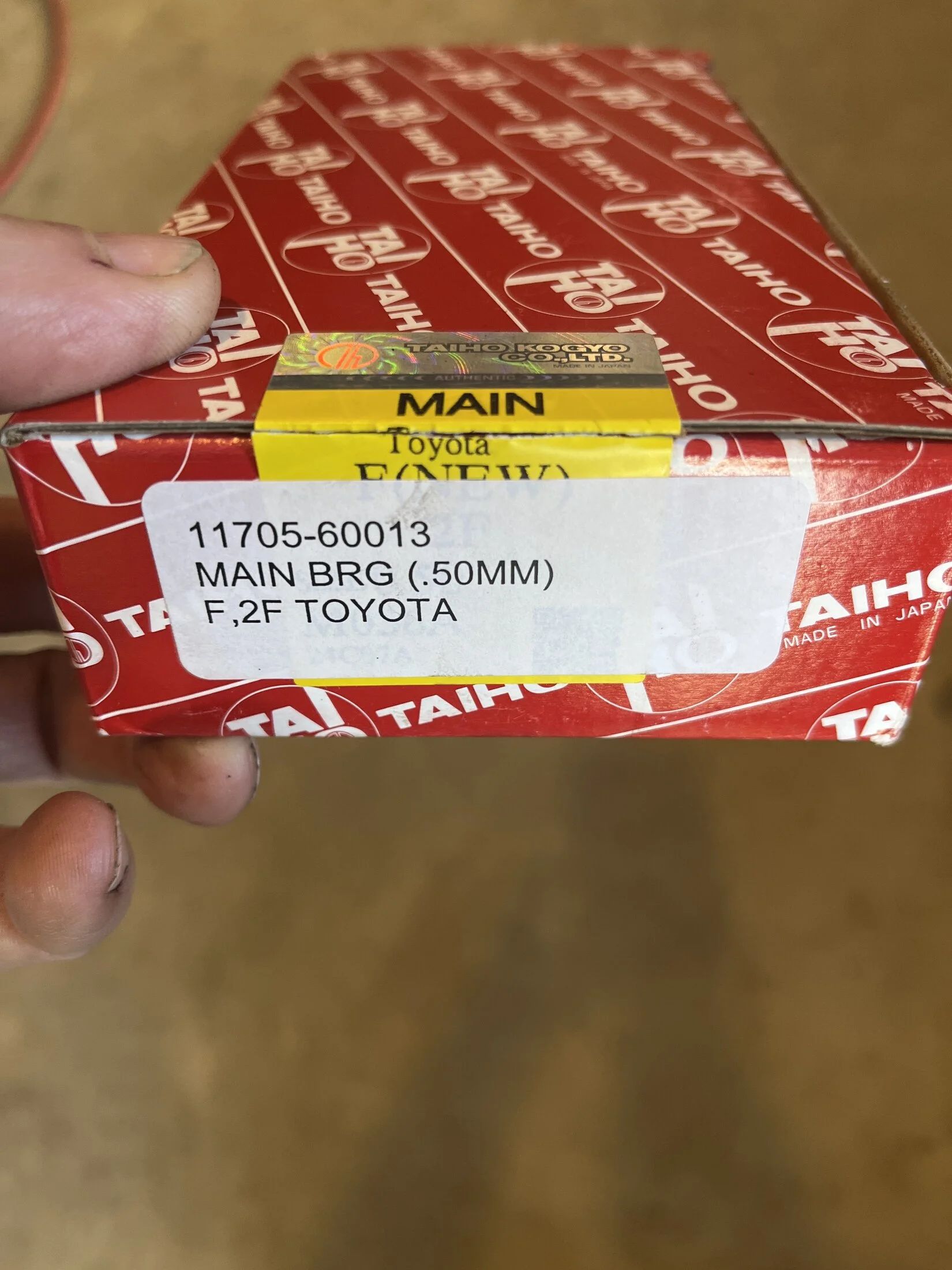

i have .050mm bearings installed with a .076 clearance. So I think a 1.00mm bearing is needed to get clearance to .026. This is way off from what I was expecting to see since machine shop told me they milled the crank 020 over. They must have just milled it 020, not 020 over. The crank now must have 040 over mains. This is the only thing that makes since to me. I am not an engine builder though.

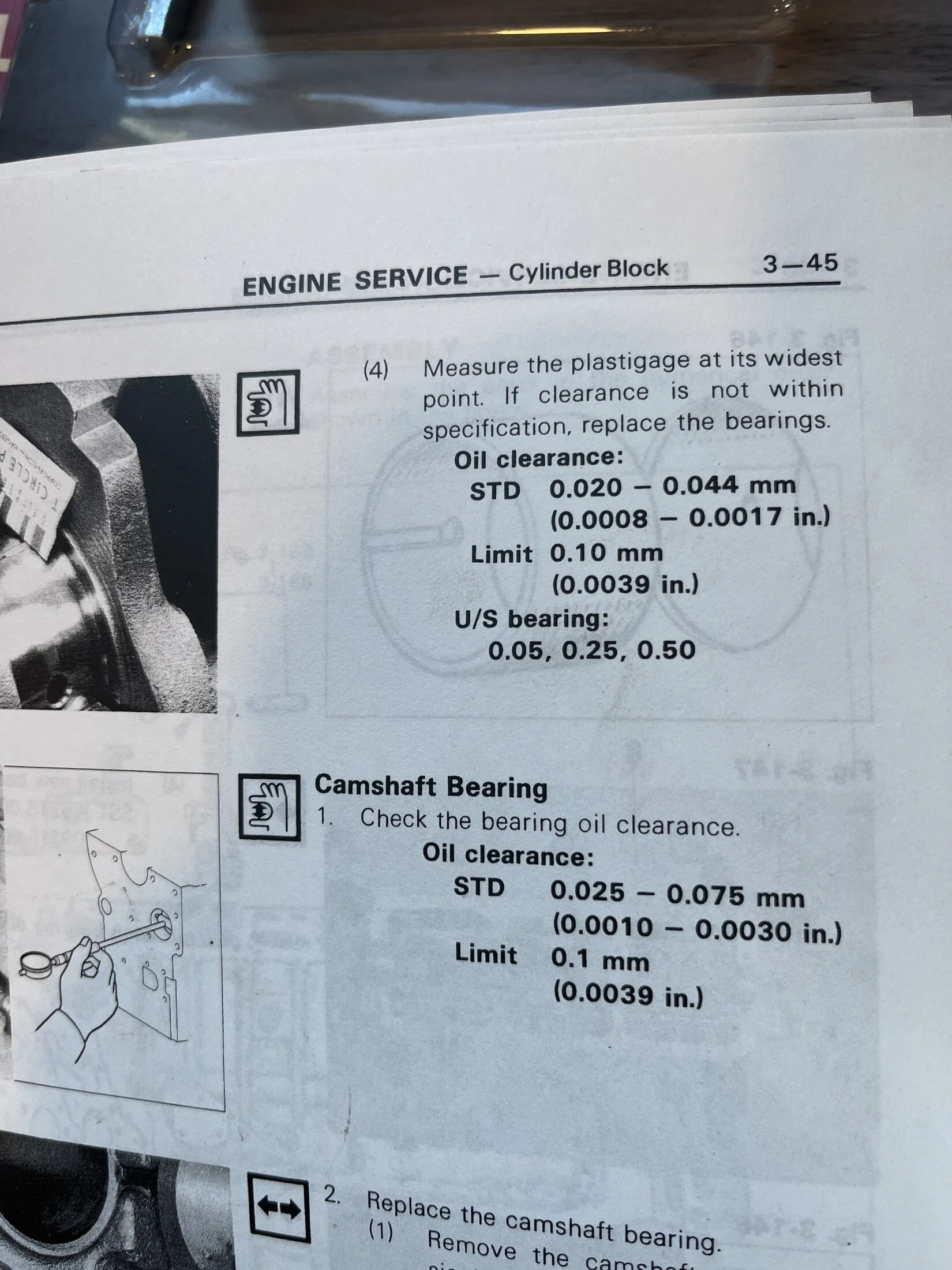

My Haynes says oil clearance on main bearings is 0.035/0.045mm standard to max 0.1mm. Bearing undersizes mm .25, .50, .75 and 1.00
