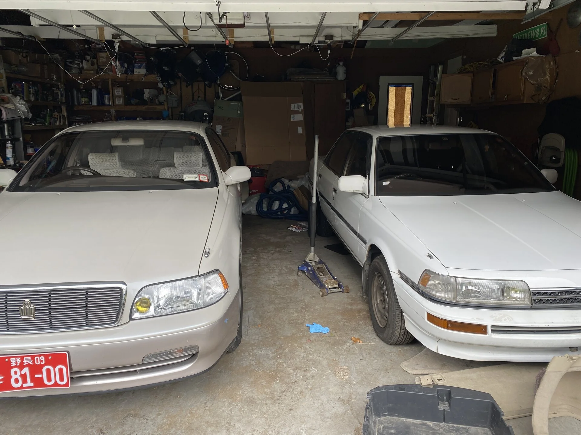

Hello! My name is Drew, I am new here. I am from the RURAL northwest corner of NY state in the US, about 600km northwest of the NY the world knows. ANYWAY. My wife and I like cars from Japan. We have had more than i can rattle off. She kept a JZS149 Majesta C Type, and I kept a CV20 Camry Lumiere G TurboDiesel. I’ve got issues and she can jump in hers and drive for 6 days straight without an issue I am sure haha
