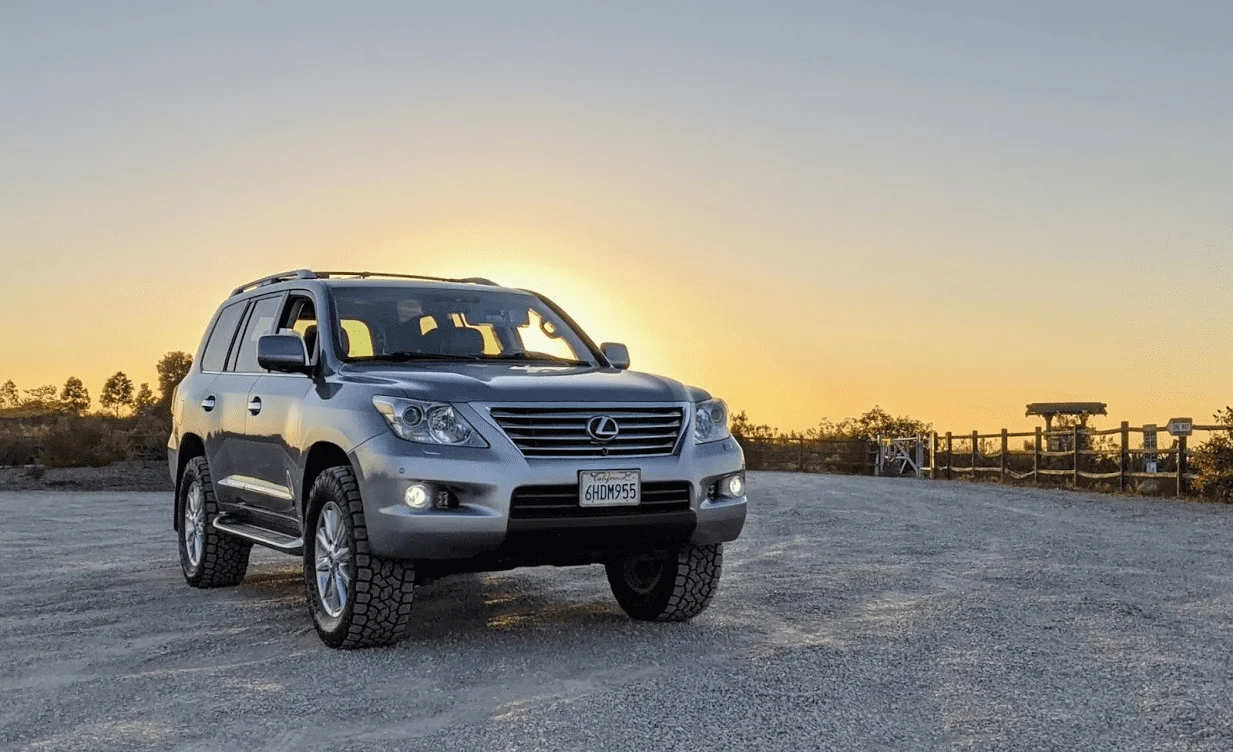

Pulled the trigger should be here by next week. Looking to get 285 75 17 Toyo Open Country AT III. No AHC lift. How much work involved for the rubbing situations? I'm ok removing the mudflaps and front rubber flap.
Thank you in advance for your inputs.
Push the front front wheel liner forward. Some plastic reshaping behind the front wheel, possibly removing a small metal flap support behind front wheel.
AHC lift won’t change your full stroke clearance, so it’s mostly just for clearing during daily driving.
that's a 34" tire. the LX doesnt have the KDSS bracket, so just as the grinch-meister said, it's and easy fit with some minor mods. our rigs have independent front suspension (IFS), so lift wont affect your fit - you'll want to drop to Lo and make sure you dont rub in the lowest height. Also, I'm not sure what offset that wheel is, but make sure you're not rubbing the upper control arm at full turn otherwise you'll need to look into some wheel spacers.
Looking at posts right now for moving the fender forward. Thank you!
Thank you. The wheels will be 17x8 ET 40. Looking to run BFG KO2 285 75 17
Easy fit. I’ll be surprised if they are even 33”. BFGs tend to run smaller than stated diameter.
