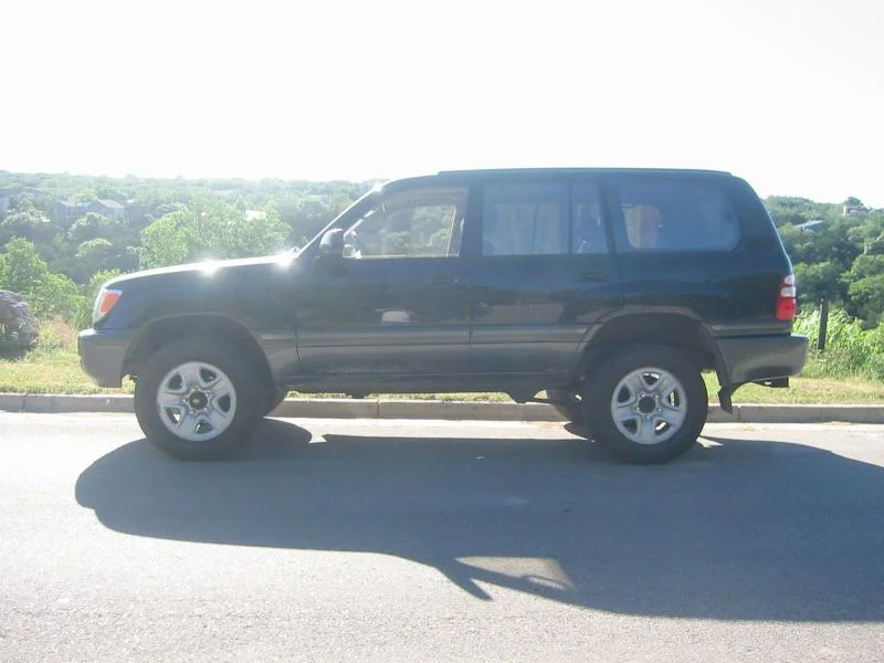

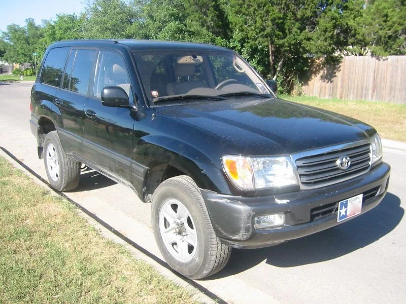

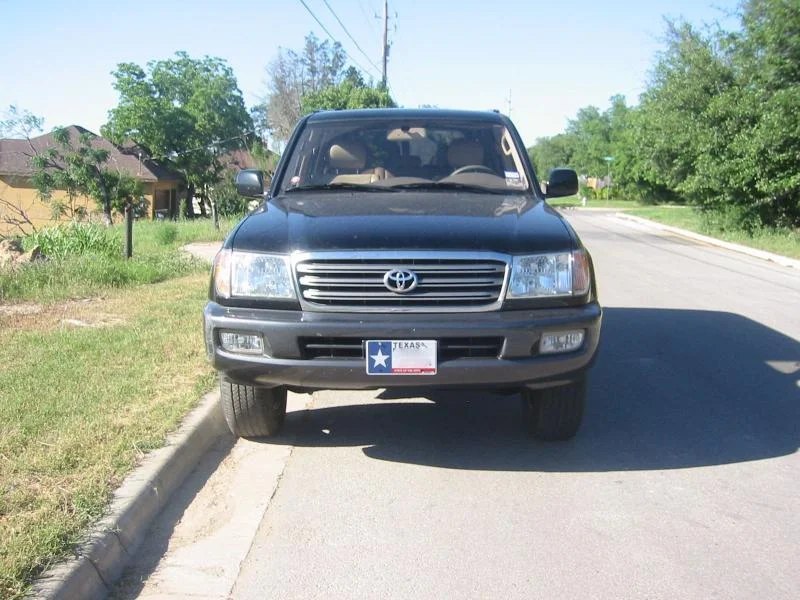

Does anyone have a picture of 255/70/18's (Tundra stock size) on their 100? I want to get a separate set of on-road wheels and tires and these steel Tundra's with new tires came up for sale. Just wanted to see if it would look too skinny.
Thanks.
staggrlee has KM2s in 255/85/16, he posted these pictures in another thread
I ran those sizes on tundra steelies for about a week while I was prepping my stock rims for new tires. It drove well...

I did the same thing you are suggesting (though with Bridgestone instead of Michelin) and found the extra weight of the steel wheels negated any tread benefit. Did 8500 miles around the country. Just rock what you have on.
Wow, that's surprising. I would have thought that at highway speeds, you'd be seeing a mileage increase. What were you getting?
Mid 14's with 275/65/18 Dueller HT's. I had previously done Phx to Yellowstone around about and back to Phx at 16+ MPG's on 16" OEM alloys with 295/75/16 Nitto TG's. Both the 255's and 275's I ran are nominal 32" diameters. ~0.8" difference in width. You'll never make up the purchase price in fuel savings. I though I would, but didn't, even after selling/giving them away...
