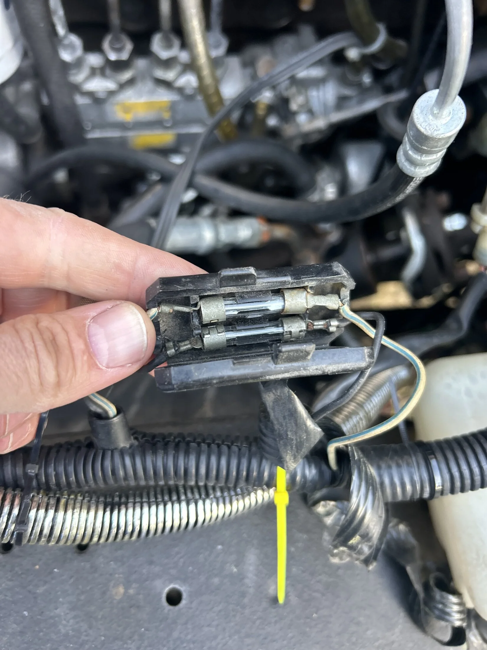

this is what I have

What you’ve pictured appears to be an accessory fuse, not a fusible link.
Although not 60 series specific, this thread gives some good info on them.
That double fuse is stock on the Cdn BJ42 harness. Don't quote me, but I believe that is for the ameter in the dash cluster.
Coming off the positive post of the left side batter (24V side) there should be a fusible link, which supplies the main harness. I've been looking through my photos, but I do not have a clear picture of the factory setup at that post. If I find one I will post it for reference.
Can you post a photo of the harness coming off that positive post; Should be just up the harness from the double fuse.
