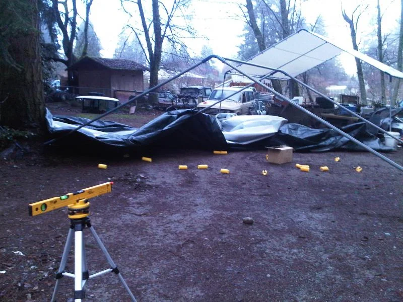

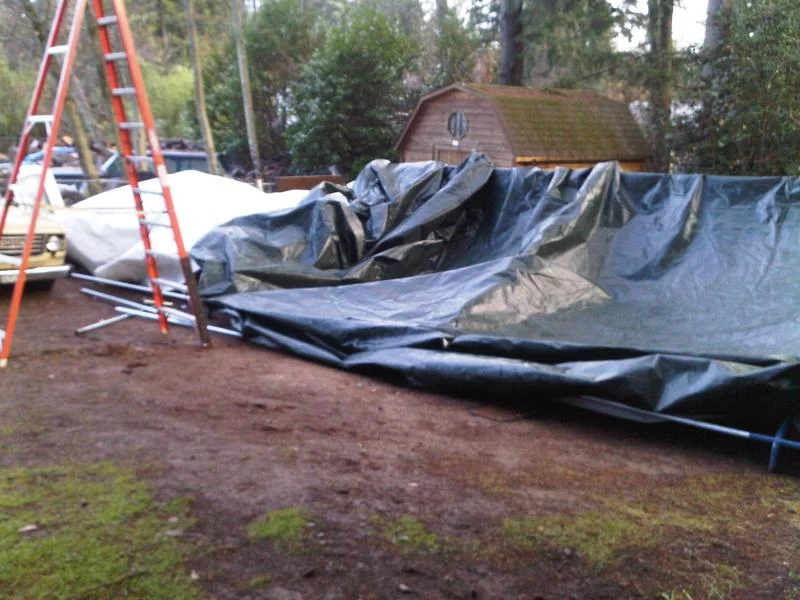

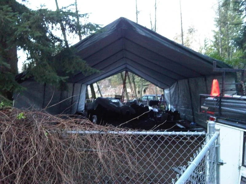

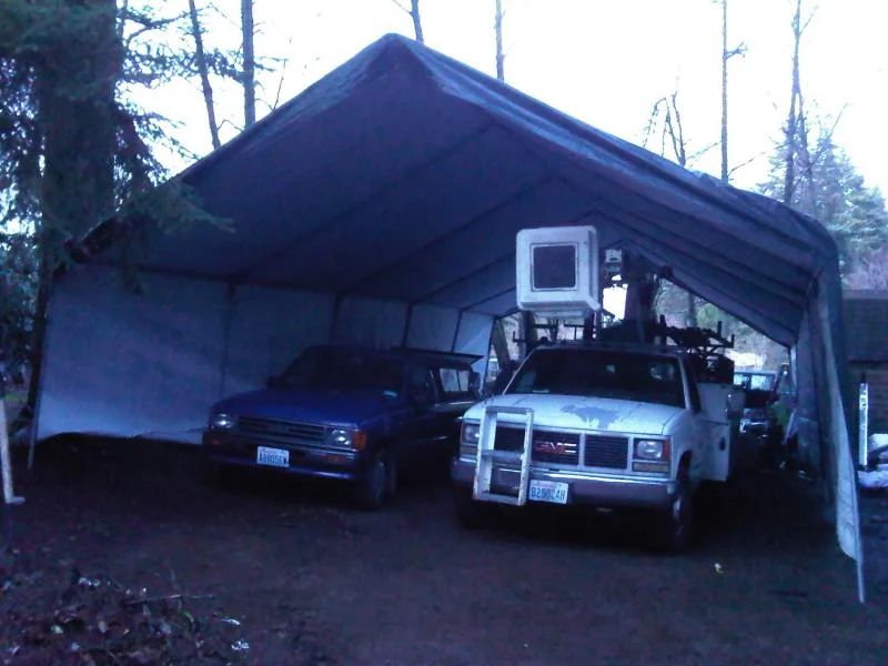

Posts are useless without pictures, so I snapped a few of the installation so far.
You can see the 20 x 20 that I replaced with this one.
