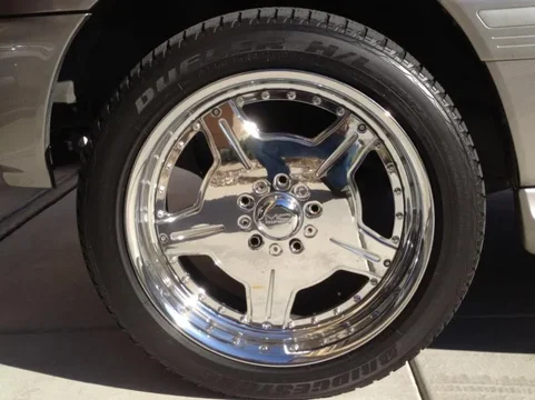

I'm noticing that a rather large number of cruisers I'm looking at have aftermarket wheels.
I prefer stock.. and a few of them I would have easily bought if I didn't need to shell out over a grand to replace wheels/tires.
Anyhow, 22" seems super large - does anybody have experience with them and how they impact everyday driving?
I've been rather impressed with the stock 100 ride characteristics. What to expect with these large rims (until I get rid of them)?

I have noticed many cruisers w/ these large rims though... and considering how few cruisers appear on the market I am starting to consider them.
You might be able to have the aftermarket wheels work to your advantage if there's demand for them in your area. Sell them and replace with stockers or tundra stockers for cheap and maybe net some cash.
I agree with Teck. 22's can sell for quite a bit. A buddy of mine just sold some chrome 18's with 35" Toyos over the weekend for $2200. You may end up making money.

Drove a loner Tahoe with 22"s and it rode like crap.
One can typically find full sets (5 wheels) of 16s or 18s here in the classifieds for 250-500. The top end of that price will get you wheels in near perfect condition, many times with lug-nuts. Anything higher than that and the person is asking too much. car-part is another source for OEM wheels priced under $100ea
I have 2 LC 100s. The old one runs on standard 16 while the other with standard 18s. Even with AHC equipped on both the rides I can feel a lot of difference in ride quality. The 16 s ride much softer while the 18s look better.

Two very excellent points: it seems some brands of 22" are rather expensive! You're absolutely right the cost of replacing could be offset. Also, thanks for the note on $100 / factory wheels here at mud classifieds! Perhaps that would make my replacement closer to 1k.
The added suspension wear is interesting... I do suppose something has to catch the extra bumps vs the tires. It really does look like the tires only have 4" of air.
Well, I'm not surprised the mudders don't roll with 22s :)
My 100 had 22s when I got them. First off, I thought they were ugly. Second, and more importantly it rode pretty rough and they rubbed on the wheel wells. I'll sell them for cheap as they are just collecting dust.

My 100 came with 20in rims on it and it rode like crap, as soon as I put a stock set of rims and wheels back on it was much much better.
