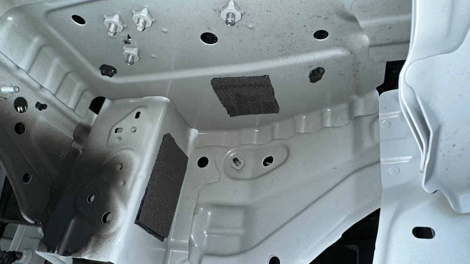

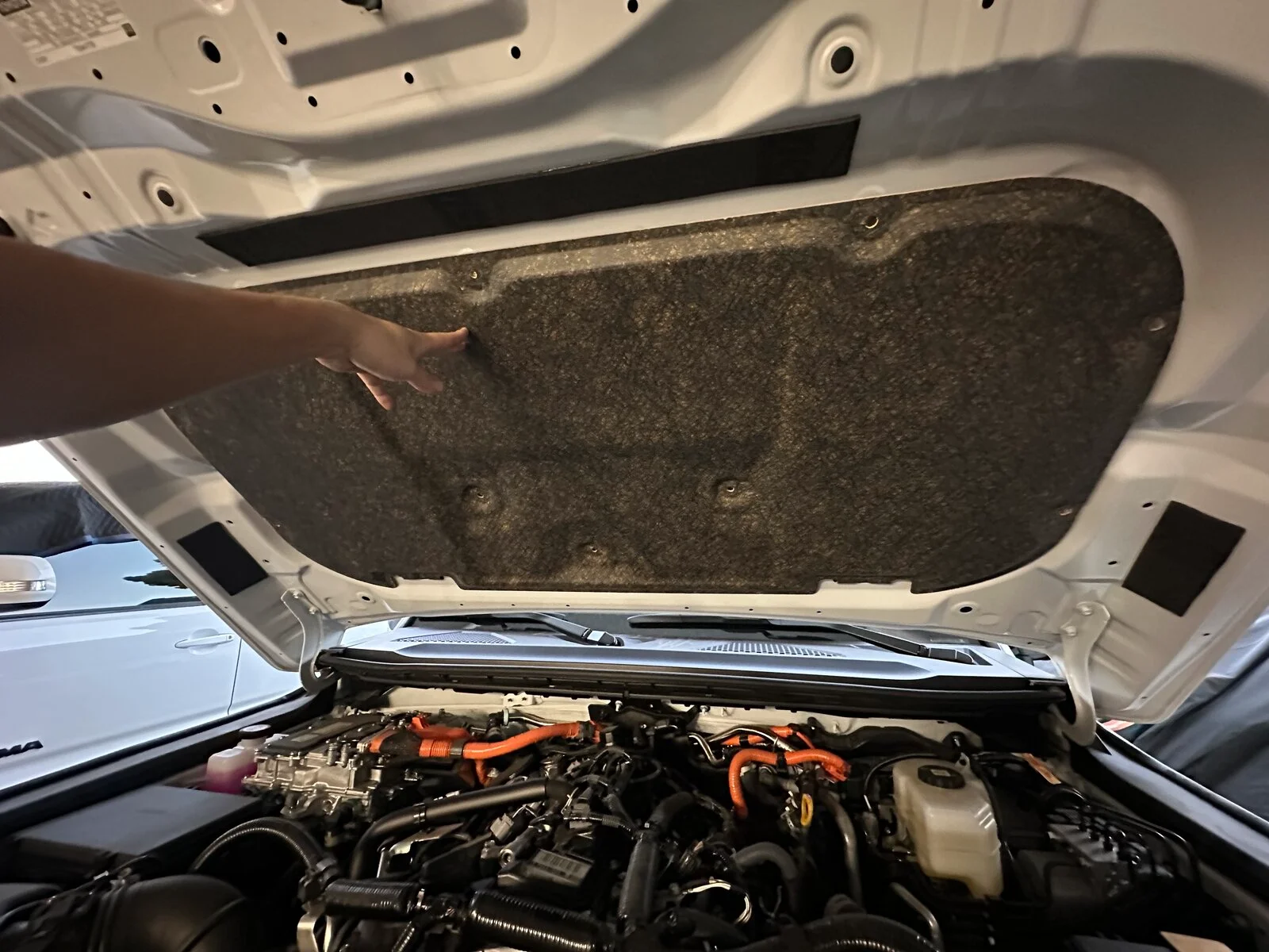

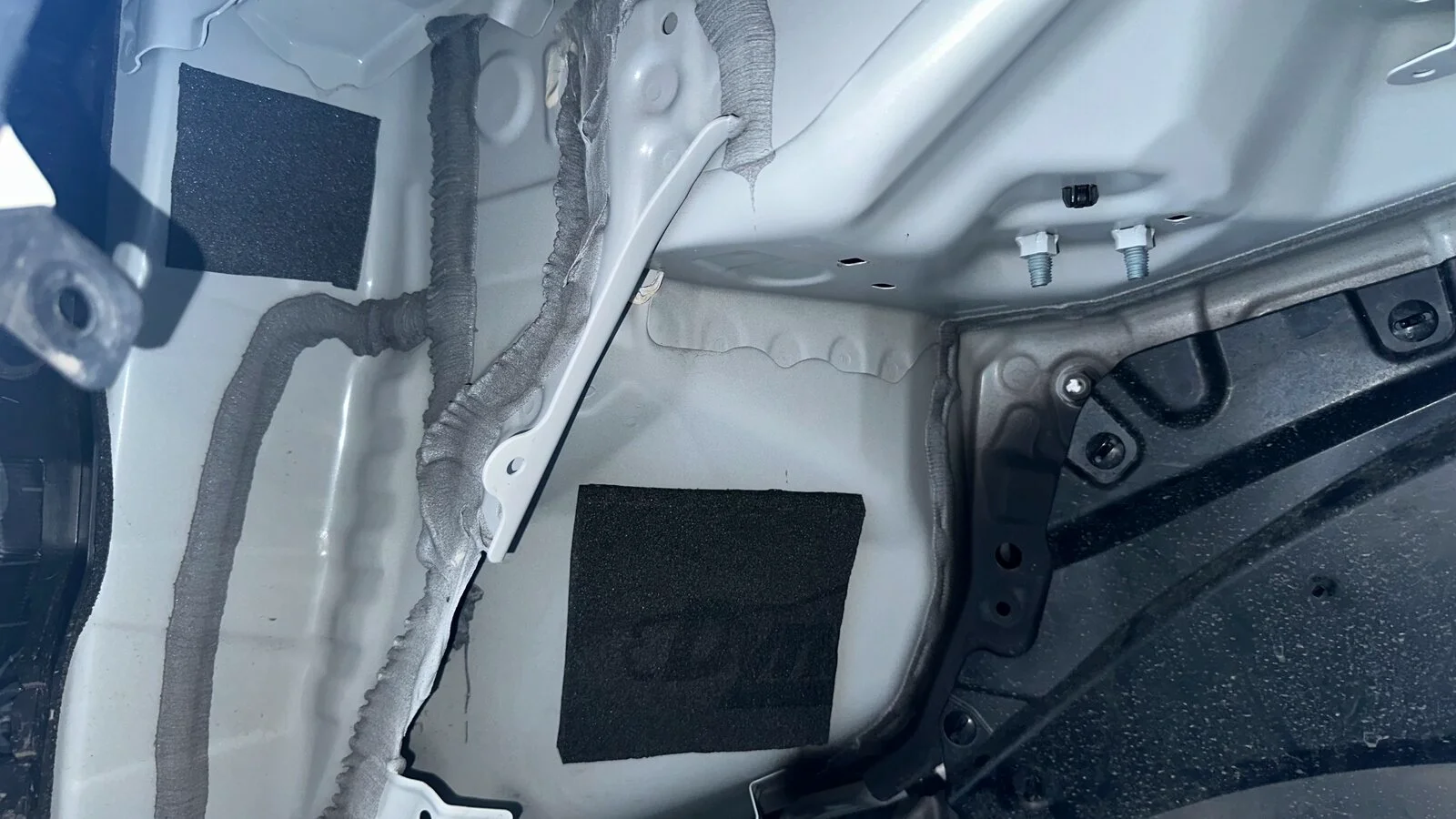

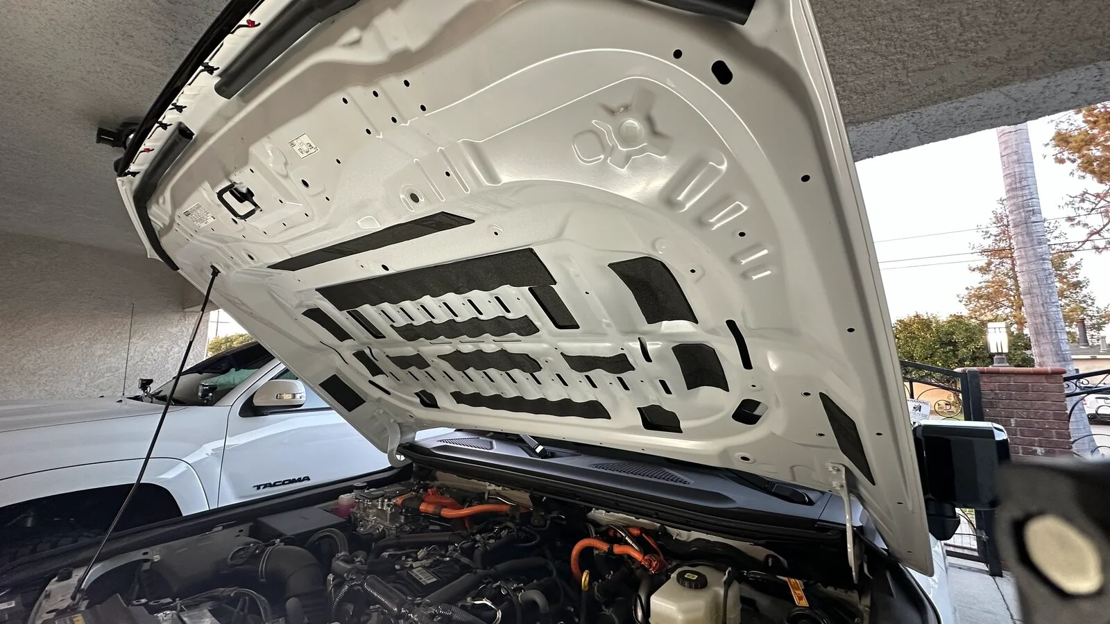

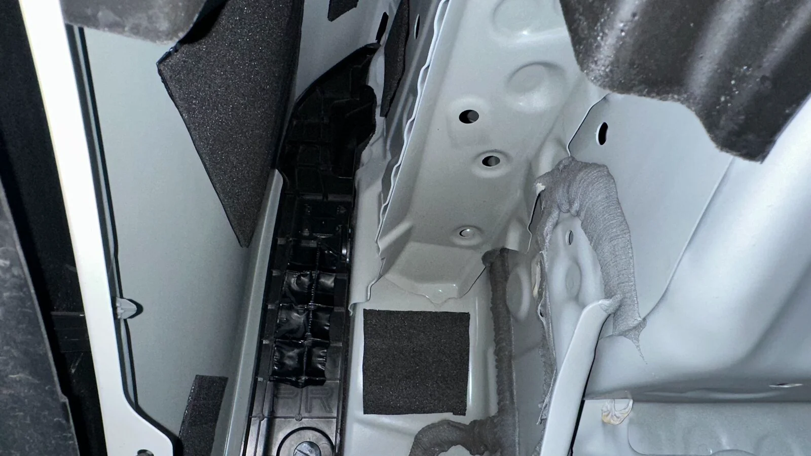

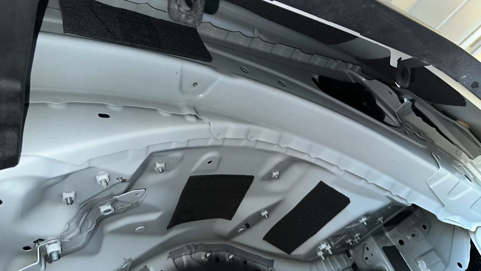

Kick started the sound deadening project starting with the front clip. Doing the exterior panels on my Tacoma resulted in a huge dB drop, so that is why I opted to do the exterior panels on the LC250.

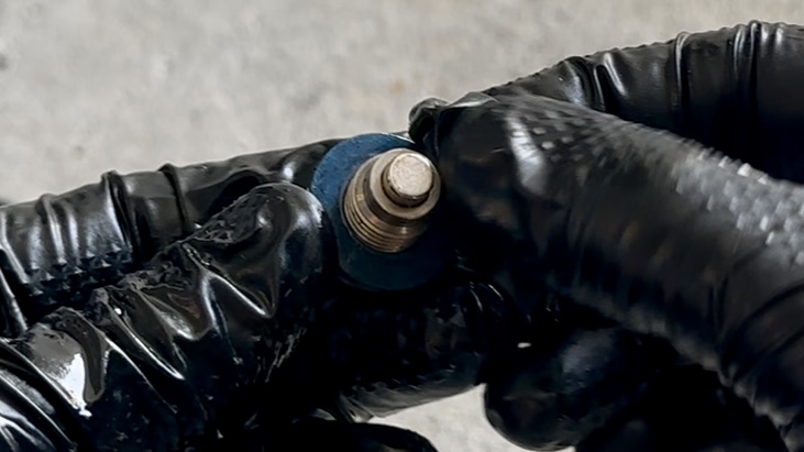

I got the hood finished up today, but will need all new clips for the insulator (no way to take them out without destroying them). Tomorrow I will remove the wheel liners and start treating under the fenders.

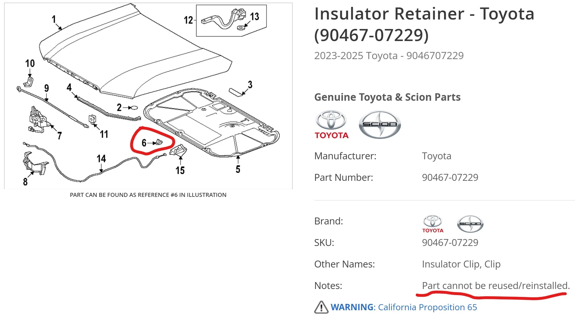

Heads up! The 10 retaining clips that hold the insulation on are NOT REUSABLE. Here is the replacement part number:

That's a massive reduction in decibels for just doing the hood and front fenders, which I would have assumed will have much less impact than the doors or floor.
