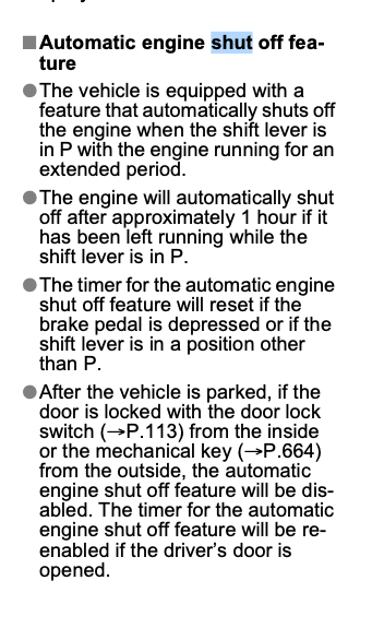

I looked in my LC200 manual...nada. Nothing, no mention of any auto shutoff. Went in using TS....again, no easily customizable ECU settings (not without a reprogram anyway). So then I researched 2020+ Toyota RAV4 Manuals. For those of you not familiar, the Toyota LC200 (and its various derivatives) share nearly the exact same ECU and CAN bus configurations and codes as a Toyota RAV4. After searching the 2020+ RAV4 Manual, I located the Auto Engine Shutoff feature on page 198 of the RAV4 Owner's Manual (see attached screenshot).
The RAV4 manual's workaround works. If you start the car and want it to stay idling (car camping in subzero temps, trapped in a blizzard traffic jam, or you're watching a drive-in movie), then simply lock the DRIVER'S SIDE DOOR USING THE DOOR'S LOCK BUTTON. This works if you put the window down as well, but regardless, if you plan to sleep in sub-zero temperatures, then you will need to lock your driver's side door and crawl back from there to go to bed. Before anyone starts spouting off about electric blankets, etc., keep in mind that if your vehicle turns off below certain temperatures and you don't have a block heater with access to a plug, your vehicle may not start again. I have tested and confirmed the 58 minute cutoff, and I have tested and confirmed that it is disabled with the driver's side window rolled down and the driver lock button pressed. I have not yet tested if other doors can remain open when locking the driver's side door or if the vehicle has to be completely buttoned up.

Only downside with the Toyota-approved workaround is that in order to watch a drive-in from the tailgate, you'll either have to roll down the driver's side window and lock it, or you'll have to crawl over the seats to get to the back.
It does say that you can use your mechanical key to lock the door as opposed to rolling down the driver’s aide window and pressing the lock button.
Yea, I read the same - use the mechanical key and you should be good. make sense for leaving it running for AC or heat. Good info though, I’ll have to try this on my 2015.
I have no plans to test this, primarily because I have my smart key inside a leather protective cover, so using the physical key is possible, but a bit of a hassle. Remember, that's from a RAV4 manual; but your theory is sound.
