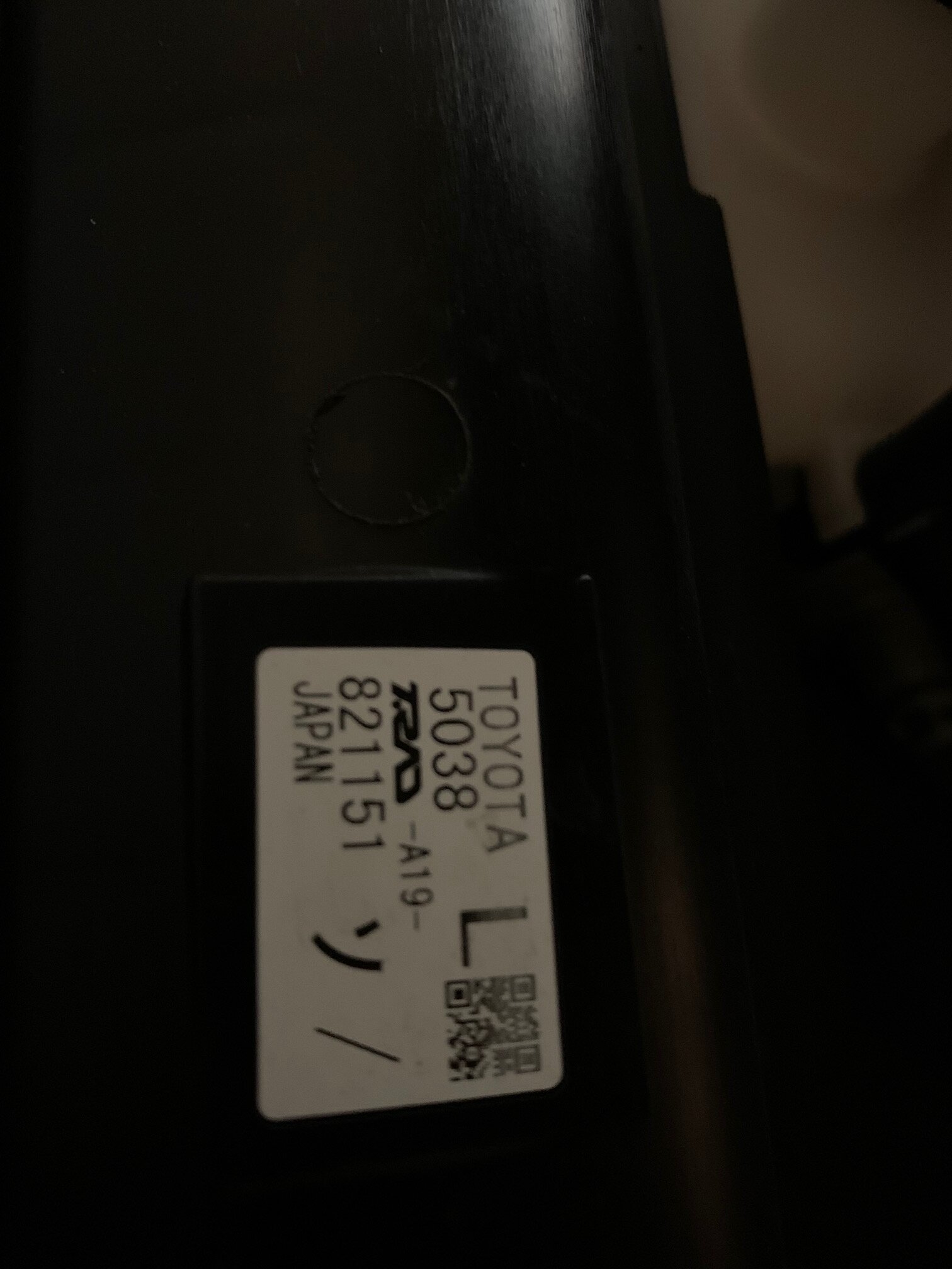

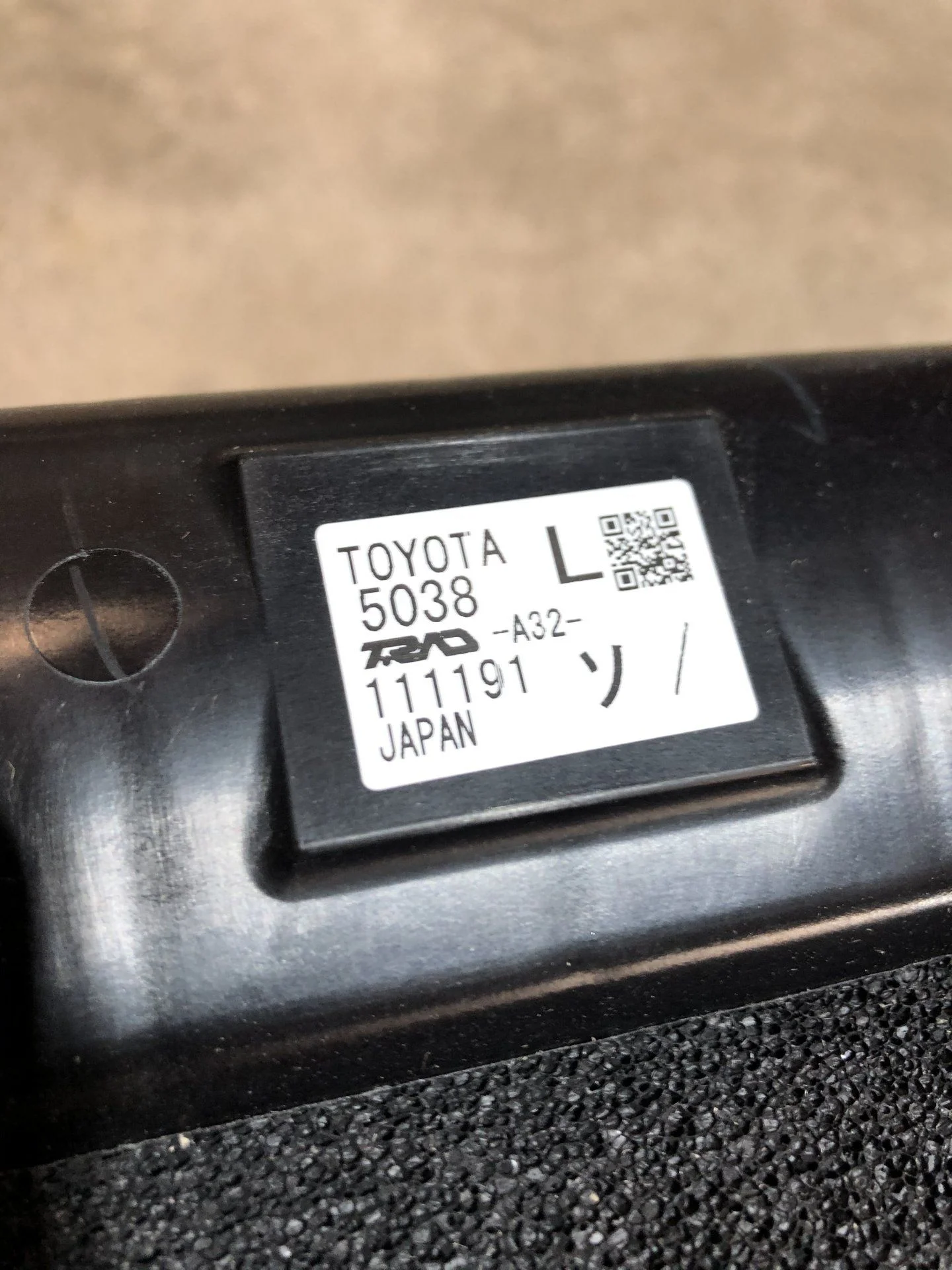

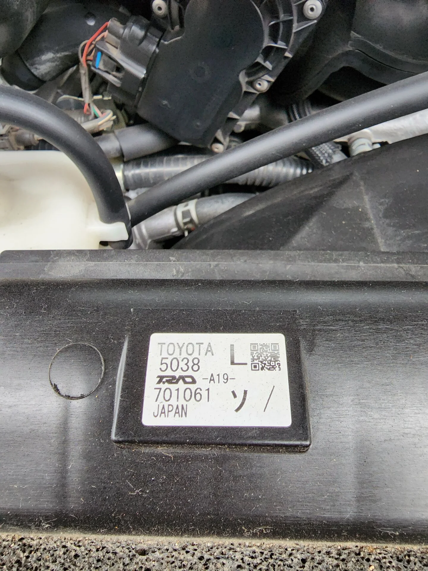

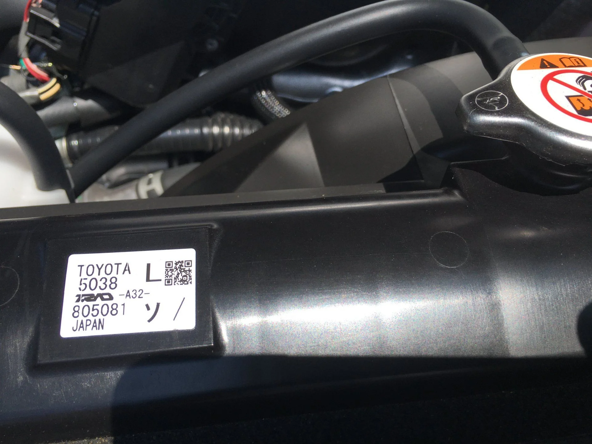

A picture would probably be the easiest way to tell. The raised square area on top next to the filler neck with the part number printed on it.
Plenty of info here:
From factory 2016
seriously, there is like 8 part numbers in this thread. Every picture has a different number.

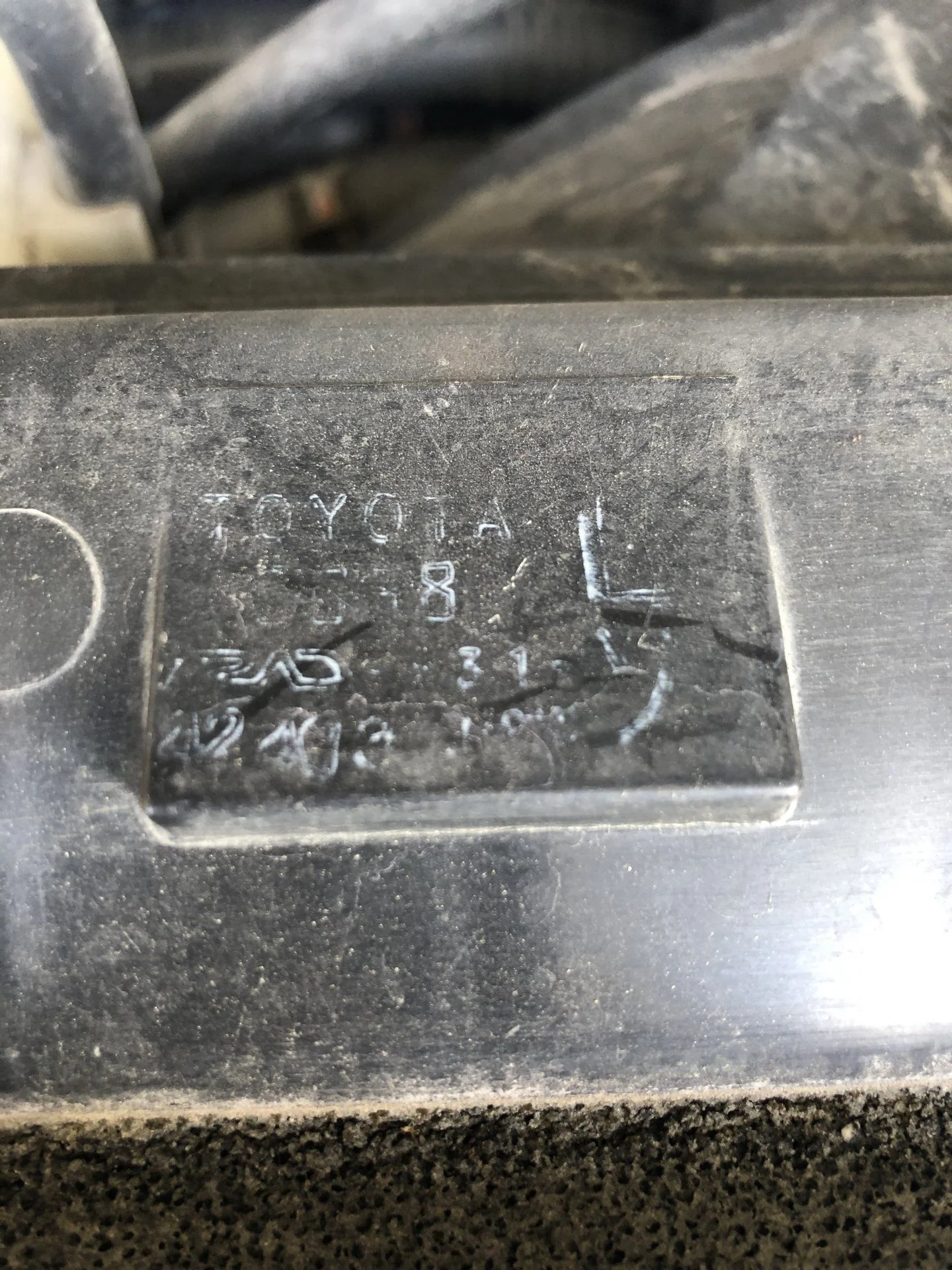

I recently purchased a 2016 LC200 with 113k miles. Radiator looks brand new so it was probably replaced recently. Per carfax, there's a deer hit last year so maybe that's when it was replaced. Here's a picture of the sticker on the radiator -- looks to be the new version. Anyone can confirm?
That actually looks like it may be the old style, but I can't tell for sure.. can you take another picture with better light and less zoomed in?
