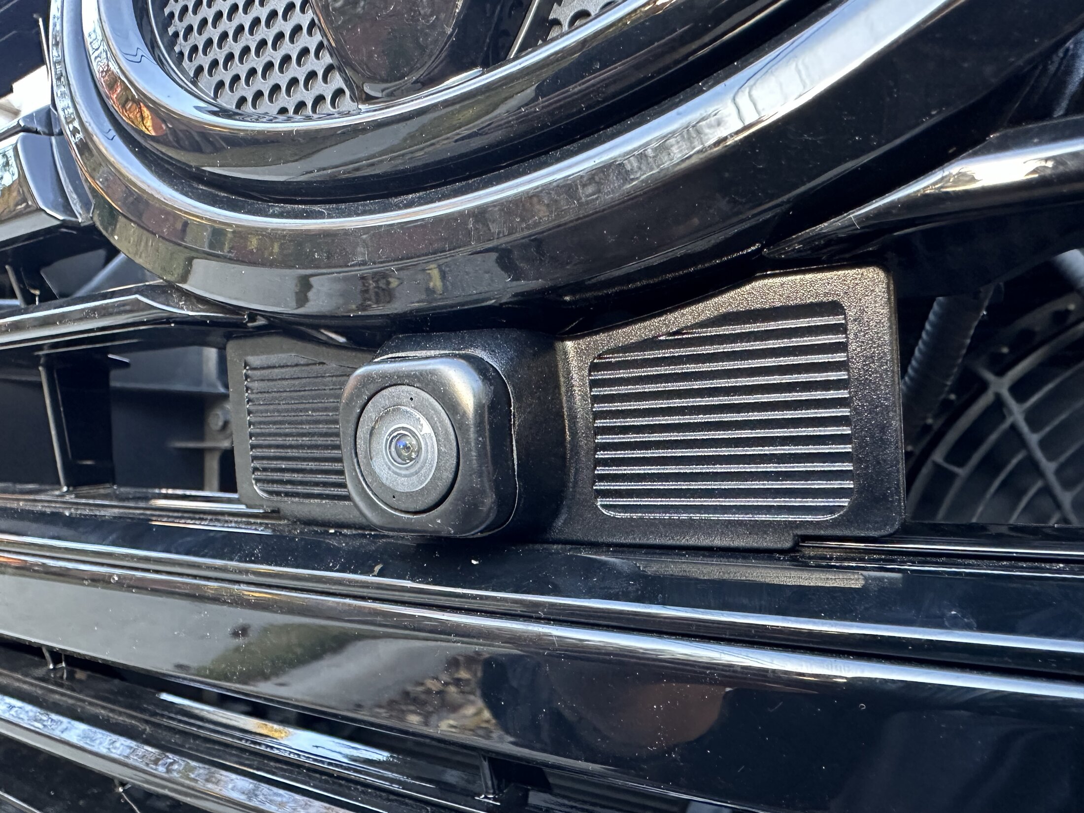

I recently swapped my OEM grill to a blacked out one and ran into a pretty big issue with the camera mount. I didn’t realize until after I pulled off the OEM grill that it didn’t have a mount for the camera. Contacted the seller in China and after another 2 weeks, they sent me a mount that fits nicely in the grill but not with my OEM camera. To make matters more frustrating, the replacement grill has a support pillar in place of where the OEM grill has a location to mount the camera. The link below with all my photos should be easier to comprehend!

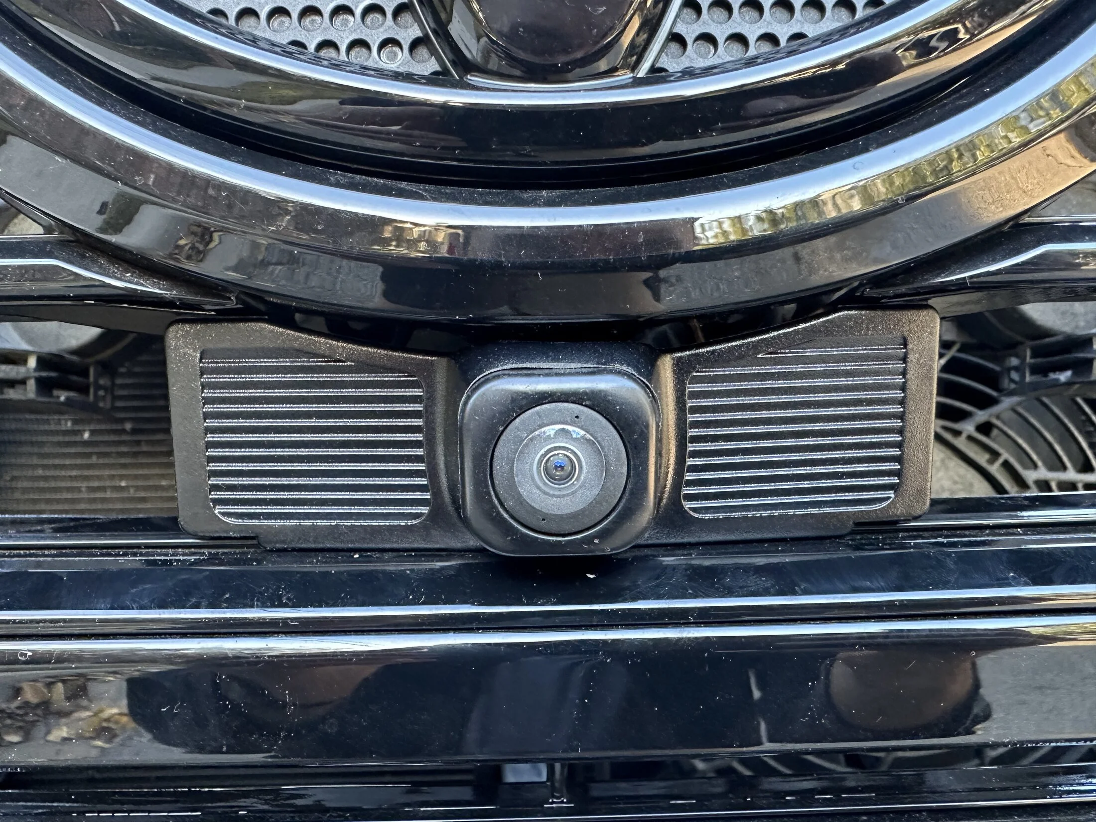

After not making any progress on this - I took a dremel to the non OEM click in camera mount and removed enough material until the OEM camera almost fit through. Used a heat gun on a low setting and press fit the camera in there. It’s not perfect but for the last 2 weeks I haven’t had any issues!
