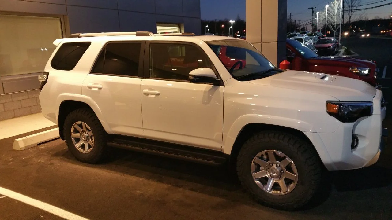

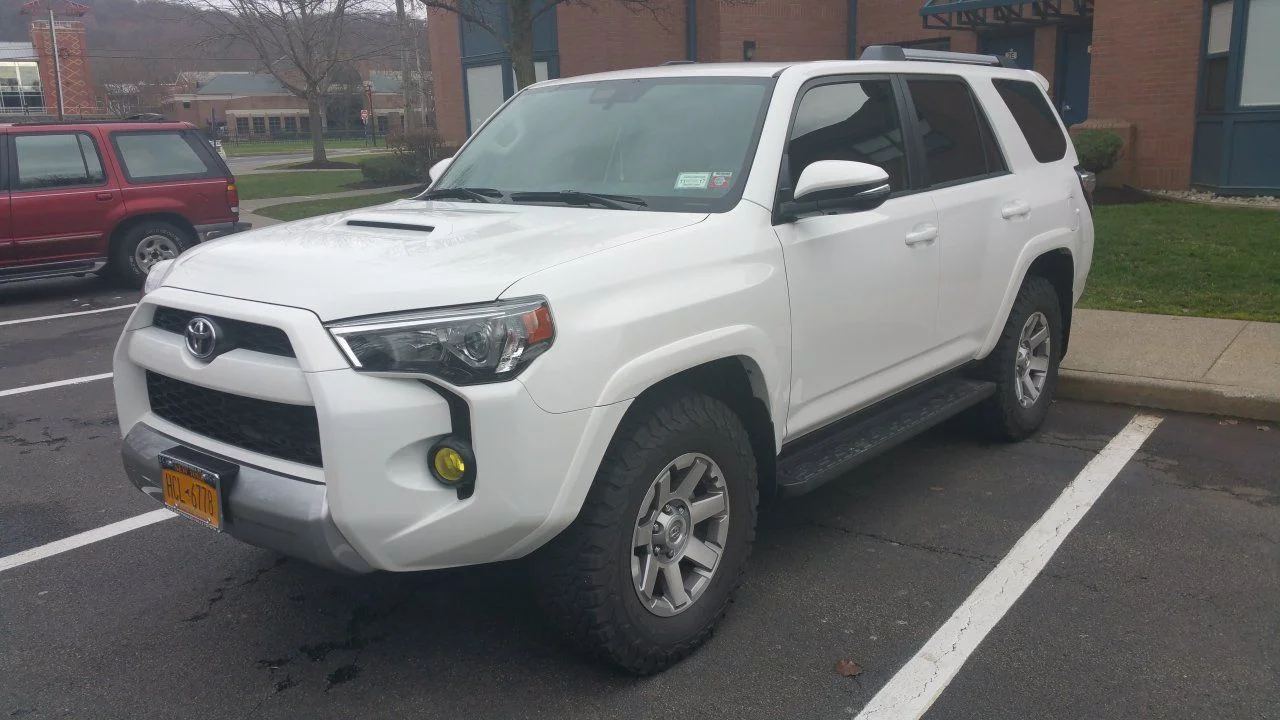

First thing was the BFG KO2's E rated before she even left the dealer. Next was front windows 35% and yellow Laminex for the fogs. Rear LED back up bulbs are in.
Christmas break will be Airlift 1000 airbags, electrical upgrades in the rear compartment ( USB's, 12 v dedicated fridge outlets on each side, and a 6 circuit Blue Sea panel wired back to the house battery with a 100 and breaker and #6 wire). Then a Sears Platinum AGM group 31 under the hood.
Then I'll be doing a OME BP-51 upgrade in Feb./March. Aluminum skids, roof rack, and LED's in April / May
Picking up at the dealership

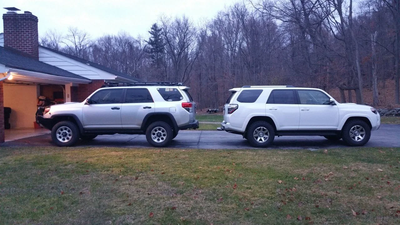

Old vs. New

Old vs. New

I had thought your rig looked different. (<----Sometimes slow on the intake) And what brand of skids?
Definitely going to do the RCI aluminum again....serves the purpose for what I use it for.
Since I tow a trailer everywhere, I will only be beating the underside up only occasionally (read a couple of times a month). So-Cal, Arizona, New Mexico, So-Utah, Nevada. I'm pretty pleased with my rig or will be when I replace the springs. After a while, you get tired of the airlifts.

I think (could be just me) the visibility is slightly better. It does cut down on the "throw" of the light outward without the lense covers, but I think it improves the overall "color" of the road in front of you, especially in lower visibility situations.
The guy charged a $100 to tint the two front windows and $25 for the fogs.

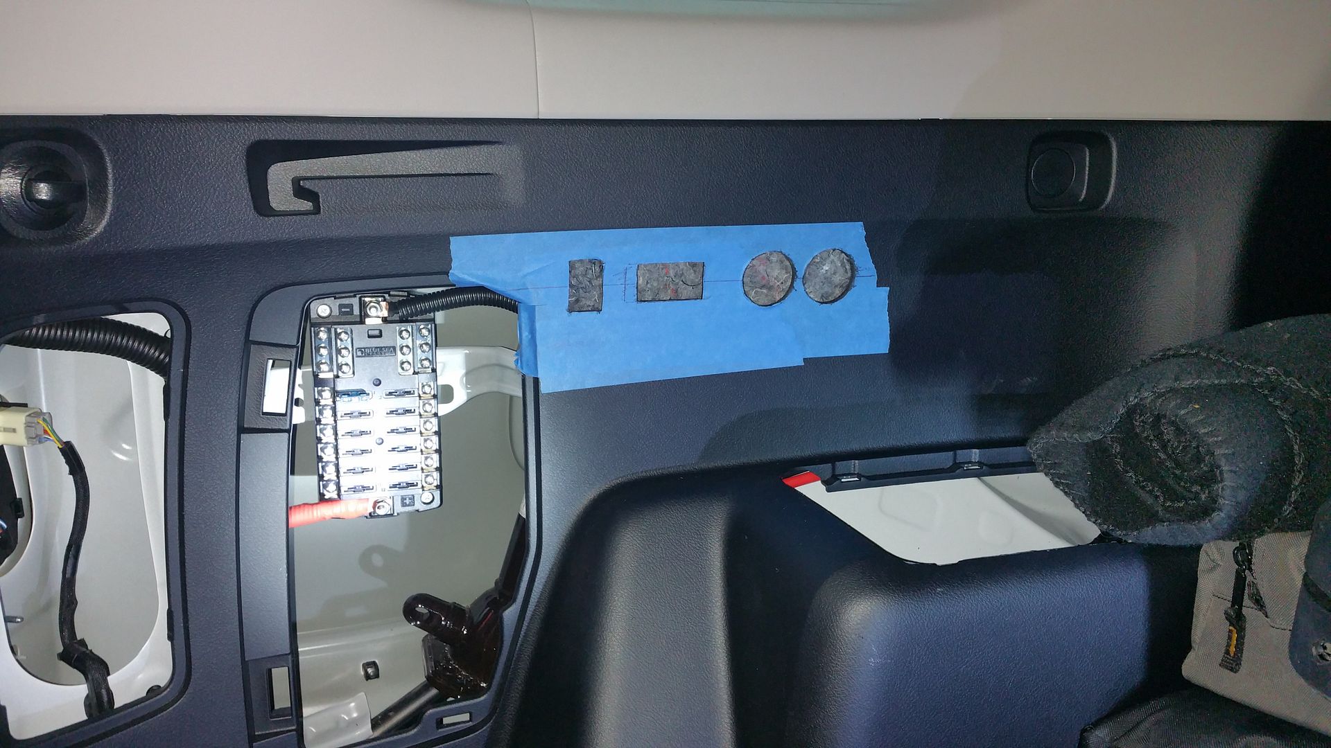

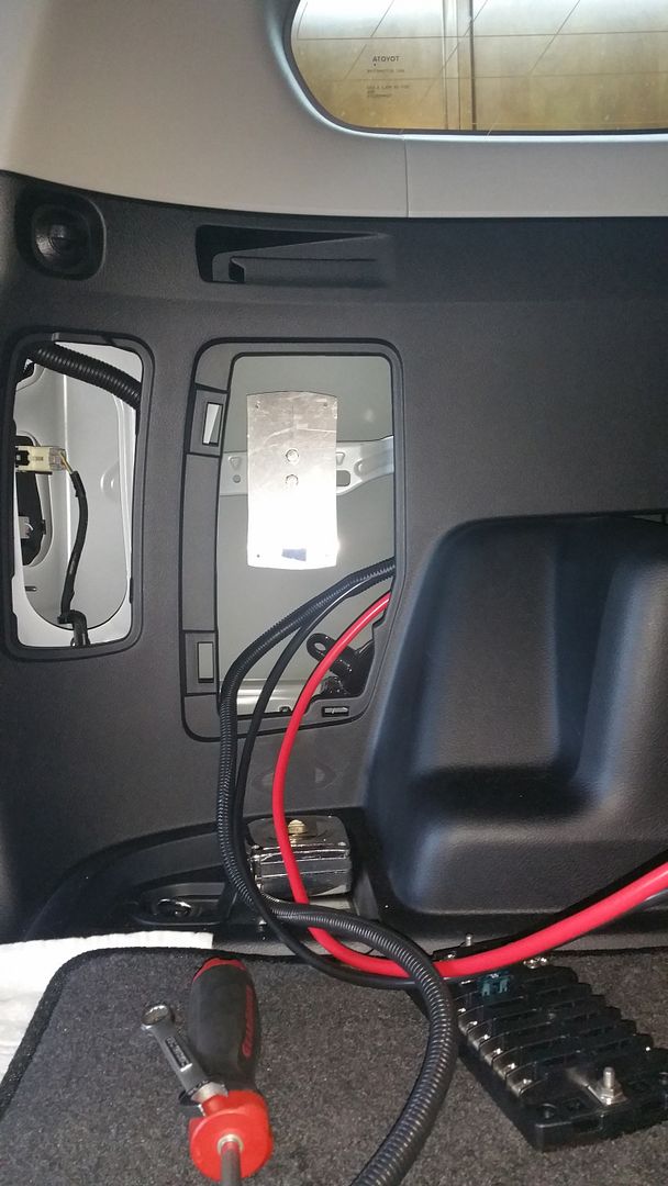

Got the #6 run down the drivers side door sills to the rear. Installed a 12 circuit Blue Sea box in the jack/tools area. I'll also be installing 12v / USB outlets on both sides, an LCD voltage readout , a NoCo female connecter, with an idiot light that also measures percentage of charge in the barely left.
The 100 amp breaker is installed under the hood, it will need to connected to the new battery when it comes.
There's going to be at least 4 - 12v fused plugs in the rear. ...and 2 sets of USB, so should be plenty for the power hungry goodies.
The new Northstar PL-AGM-31M was ordered last week at a group by over on T4R.org....saved about 75$ plus free delivery
I always get a little antsy cutting holes in a new truck...but it's kind of passed. The jack tools will get a new home in the drawer system, which I think I'm going to build on Monday. The new drawers will be about 6"-7" longer then the last set, so I should have a little extra room. They'll also set about 3" lower because I purposely didn't order the slide out tray....so fridge aces will be better.

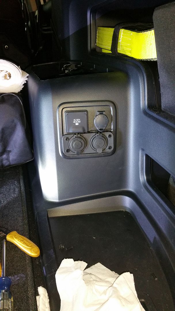

I ran 2-#12 lines to the passenger side rear...it worked out they fit into the existing piece that houses the 110v inverter plug, and a key only 12v outlet
Finished passenger side..
Finished driver side...

Nice neat electrical work what size was the main leads and did you crimp them yourself?
The new 4Runners have a little extra storage which is kind of cool. Are you keeping your rear seats installed or taking them out? I only have the front seats and that means a lot more room.
Thanks...I bought a crimper from Harbour Frieght that works surprisingly well. I used a 6 gauge from a 100 amp Buss breaker in the engine bay, down the door sills, up over the back wheel well.

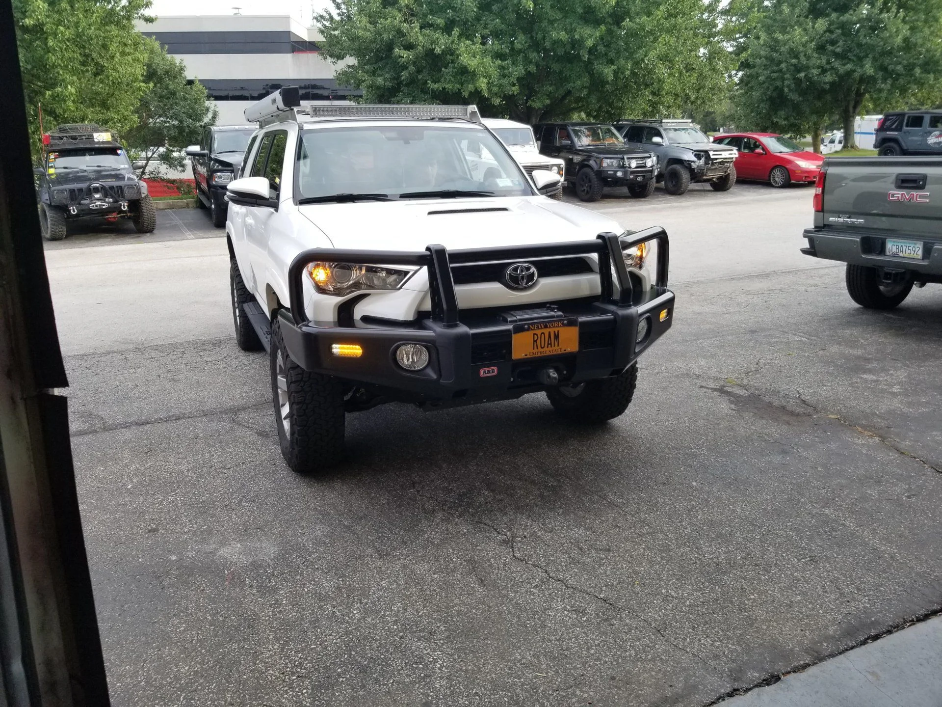

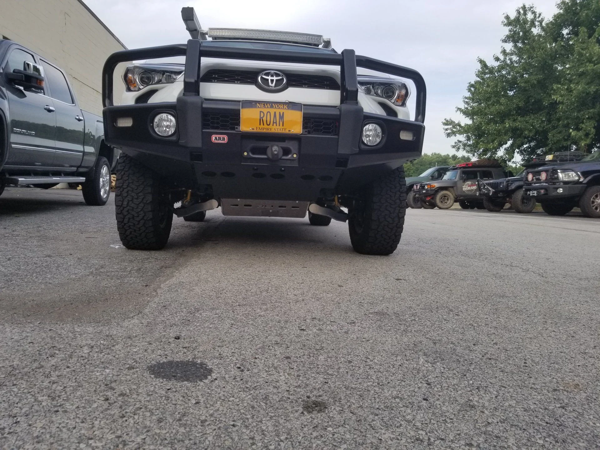

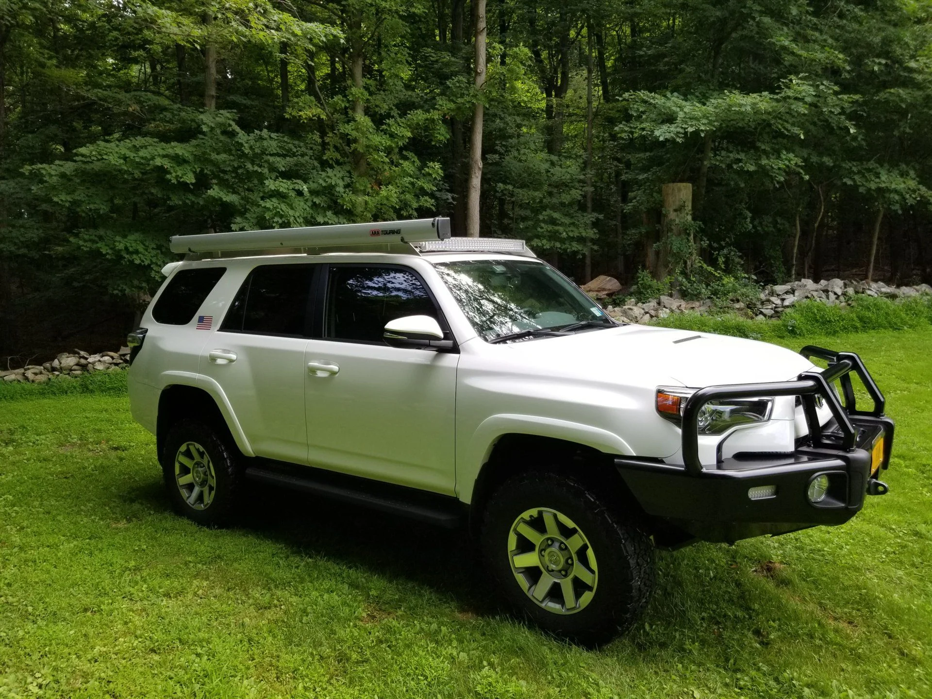

Ok...been awhile since an update...but here we go!
Started figuring out what I wanted the truck to look like, and after working closely with Pete and Matt down at Main Line Overland we were finally able to iron it all out, and assemble everything for the build. It was a breeze working with both of them, and I kinda, sorta knew where I wanted to go, but their product expertise, attention to detail, and fair pricing, made this a natural choice. I don't wheel hard enough to warrant BP-51's...but maybe in the future.
Here's what went on the truck...
ARB Summit Bar
Quadretec 9500 SI winch, synthetic line
MLO Hawse Fairlead
Factor 55 Prolink
@sleeoffroad Slee Slider/steps....beautifully made
Full RCI aluminum skids with A-arm skids
OME Nitrocharger Suspension
SPC adjustable UCA's
Spidertrax spacers
ARB new aluminum cased awning with the new matching awning room
Special thanks to Pete, Matt and Tom Henwood at Main Line Overland...good old fashioned service and commitment to customer satisfaction. Thanks as well to Steve and Jason for their hard work...they all make a great team, with a real air of professionalism, and would highly recommend them for all your off road needs.
