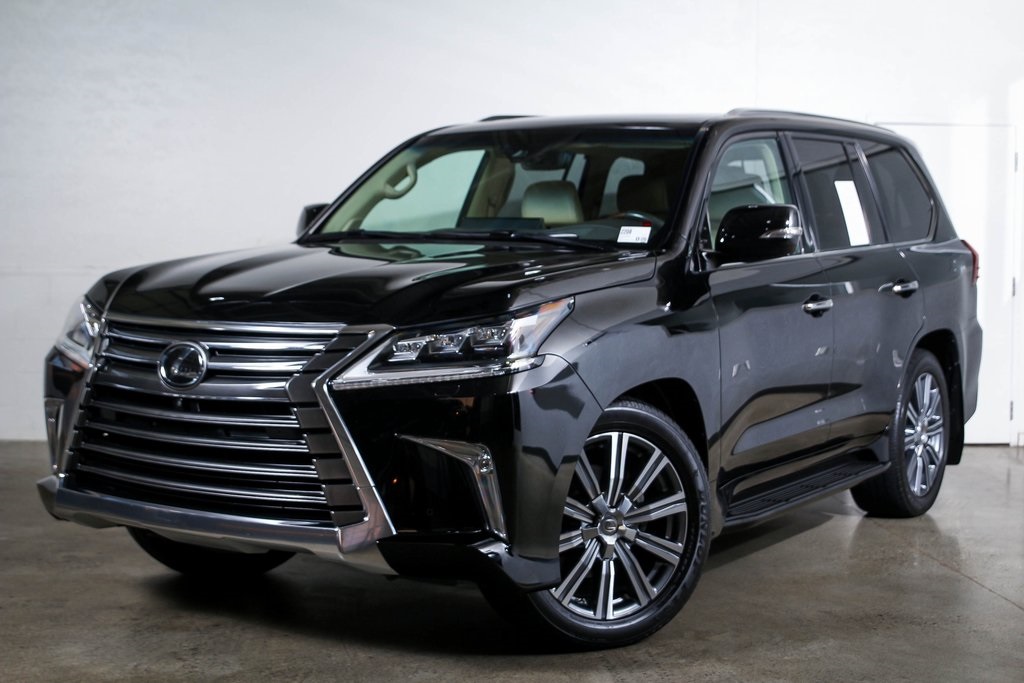

I have a new to me LX 570. I am coming from a 2010 GX 460 that was lifted on 33's with sliders. I am looking to go down the same route with the LX. I am actively researching all of the below but if anyone has some input on anything, it would be appreciated.
(dealer pic)
1. First thing, need to get CarPlay. I had the Grom Vline and it was OK, but I had some issues with the reverse camera not showing when in R and randomly freezing. I found a good thread on the options for the LX and it looks like the no name Aliexpress units are the way to go.
2. Are these 21-inch wheels worth anything to anyone? The tires are near new.

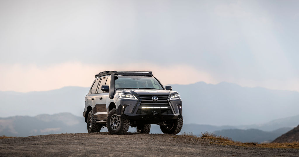

3. Speaking of wheels and tires, does anyone know who makes the wheels on the CBI J201 build? Or something similar? I really like that look.

Wheels look to be the Evo Corse Dakar. I have them in 8.5x18 with 45mm offset. Great wheel but supply chain challenges have seriously inflated their prices from when I bought my set 4 years ago.

The 21s are scrap metal. I got $1200 for my 5 on brand new yoko G056s. I got lucky.
They are worthless though since there is like 2 tire choices for that size wheel.
The evo corse wheels are great, but they are imports and prices have gone crazy (maybe down now with the $ up).
The offsets are good, but could be better IMO (35 offset is really my goldilocks).
Good news is that is the most copied design of all time. If you need help finding wheels (its our part time hobby here on MUD) let us know.

The Evo's are your basic Rally design. Method, KMC, OZ, Braid and others all offer a similar wheel design in varying diameters, offsets and colors.

But please don't stop at "look"- how they're made matters and load rating for sure. Load rating is one thing that many people don't pay a lot of attention to, but is important with these heavy vehicles. Not a place to go cheap just for aesthetics, IMO.
I've found that most 17's have a 2500-2600lb load rating, to get the 3500-3700lb load rating you need to move up to an 18" wheel.

As I recall, the EvoCorse DakarZero 17" specced for the LC200/LX570/Tundra have a 2000 kg rating (over 4400 lb).
That’s awesome but totally overkill for a cruiser.
