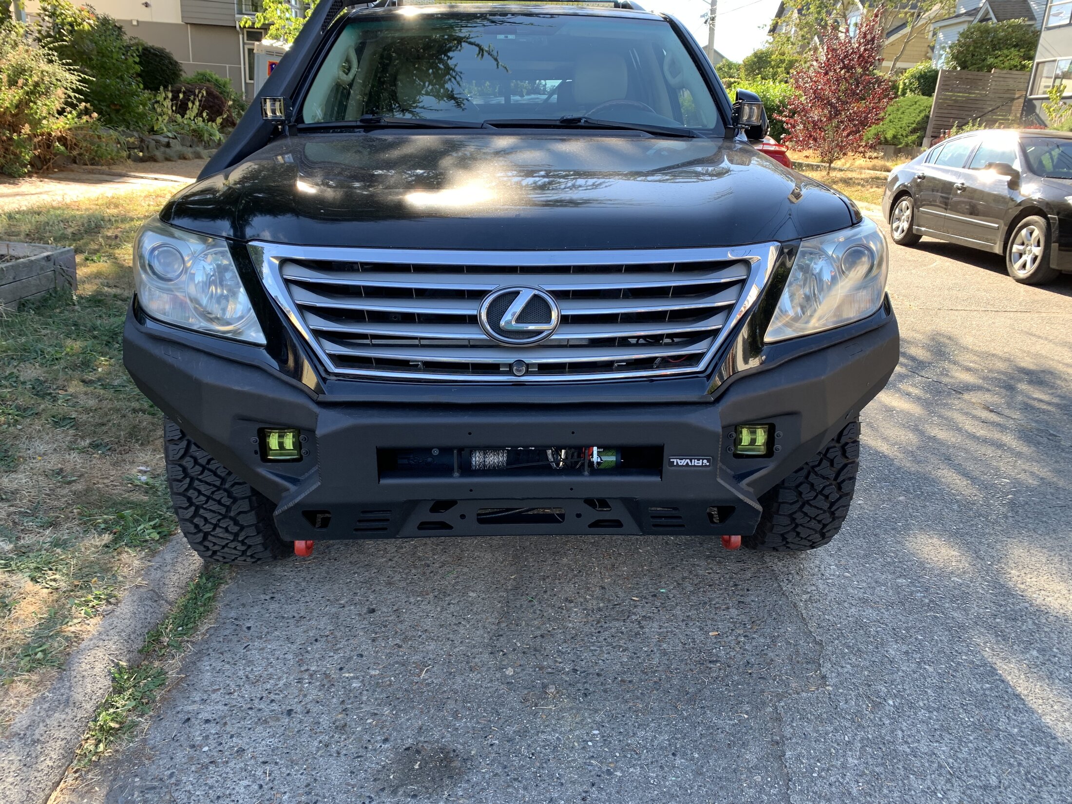

Thanks. It's actually a 2013, but I am pretty sure it will fit on 16. I would confirm with Dissent though. They are also developing a beefier version, but I have been really happy with mine. It is (relatively) lightweight, has amazing clearance, and is incredibly well built. Here is a more recent shot of the front:
Do you mind if I ask how the sensors and lights matched up or if you had to do some modification? Was reading the mountain goat build about there being more parking sensors and the lights being different.
All of the stock sensors fit and work fine. The positioning has a little flexibility. No mods on the lights.

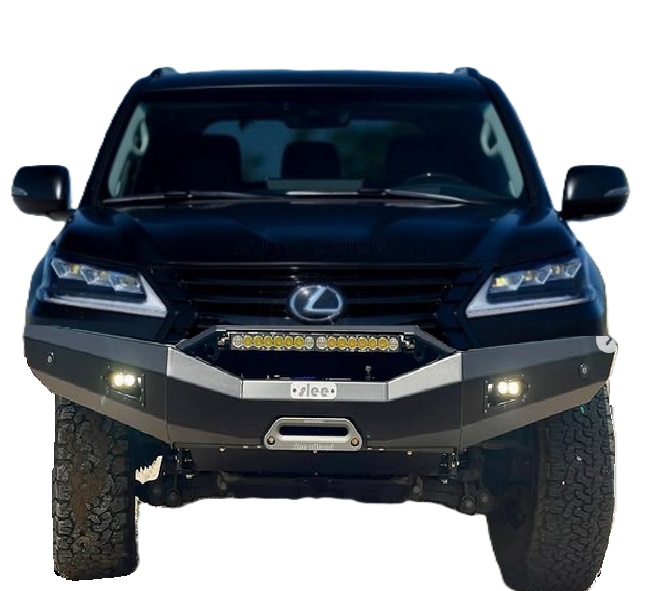

I've seen this bumper on several threads, but as this thread was indicating bumpers for 2016+ I was wondering if anyone had further insight as to why we haven't seen a single one of the @sleeoffroad products grace the front of the newer model LX570. I mean from a practical standpoint I get it - small market, convince someone to let their truck go under the knife if it even works out, etc. But it seems to match the energy of the newer updated look better than others I've seen.
From what I understand the nose of the updated fascia is perhaps a couple of inches longer which I can imagine creates interference with the light bar. This increase in length can be seen when comparing pictures of the older and newer models on the Dissent bumpers, but it doesn't look like much.
Not sure how the wings line up along the fender but after seeing the ARB Sahara Bar mounted up to it in their video I can't imagine there being much difference.
This is all conjecture of course and I don't even own a 200 - but in my search to get a 570 I'm finding myself more and more attracted to the 2016+ which I still plan on building out with what I can, bumper being the main part.
I think the ARB Sahara looks too pedestrian for the 2016+ LX.
I think the Dissent looks too busy and not clean enough.
Sorry, ramblings
The bolt up points on the lx are the same, but the lx ‘fascia’ is roughly 2” farther forward, at least on the gen1, and I suspect gen 2 and 3.
A Slee bumper will definitely bolt up. How it interacts with the fascia is where the challenge will be. There is a bar mid grill between the headlights, I had to relocate mine back, I suspect similar for the Slee.
Like anything, where there is a will there is a way. If you can model and 3d print your own grill after, or make a fiberglass grill, you’re golden.
