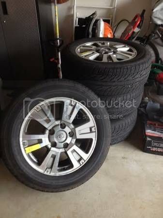

Im looking for some new wheels for our 05 Land Cruiser. I saw these 2014 Tundra wheels 1794 20" wheels. There brand new and close by me. Would they fit properly if so what about the center caps?
I test fit one of those.... I think a 1" space and 285 would work, but it won't leave much sidewall. 305's tend to be the norm but the spacers/ offset will be crucial and a lift....
they look good though..... 18's might be a better balance unless it's just a mallcruiser... weight is a factor to consider as well, that was the reason I stopped at a 17"......a light 18" that worked was tough to find....

The tires are 275/55/20. Which is pretty equivalent in size to my stock 275/60/18.
I'm not able to test fit as the seller lives 2 hours away. I was hopping someone was running these...
I believe those are the wheels from a Tundra Limited (at least here in Canada). I just purchased and installed a set of 2015 Tundra 1794 Edition 20" wheels on my '04 LX and the wheel caps fit without modification.

Has anyone else installed those Tundra Wheels? I would love to see pics. Also, I see the Canadian ones in Chrome. Those look slightly different than the wheels at the top.
