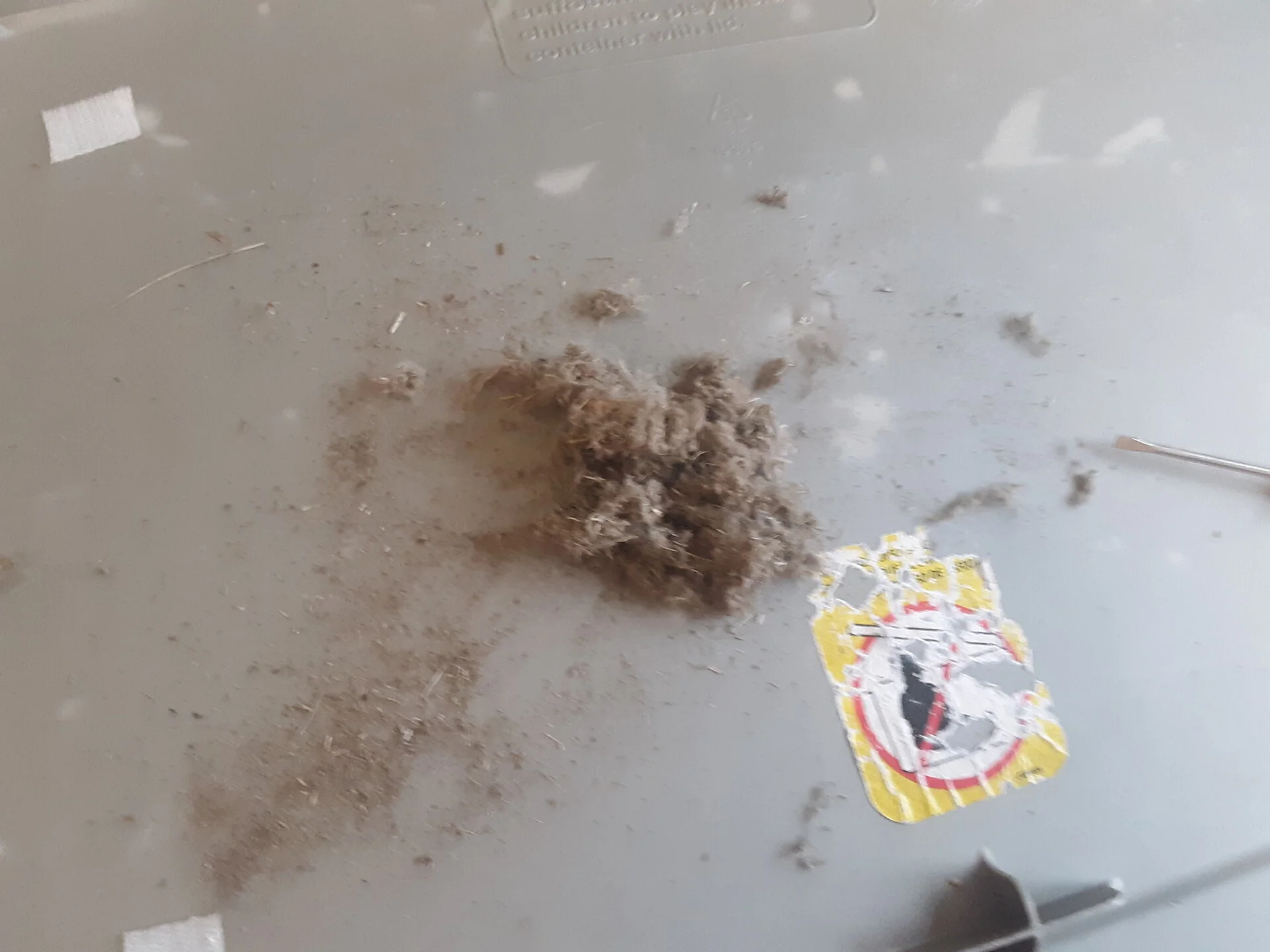

I'm headed to auto parts store. I thought I had just changed cabin air filter not to long ago. Dumped this out after I was able to yank it out, seemed pretty stuck at first. Should have checked this first.. hope it's the only issue
That should help!
It doesn't take much particulate in the cabin filter to really cut the volume of air the HVAC will push!

I got a k&n filter and it's still intermittent. I do hear a sound in blower when it is working. It's making a little rattle when in lowest ac level. Nothing as you increase it.. it works great, then nothing sometimes
Well you’ve already performed step 1 which is to clean out the rat’s nest (mine would put yours to shame, btw) so I would say you’re ready to proceed to step 2 which is to kick the Shiite out of it until it starts to work right.
