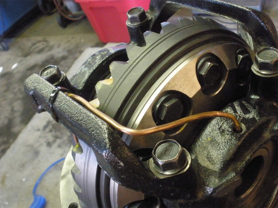

I've looked into this myself (I have an 08 DC Long Bed TRD Sport). In short, I think by the time it's said and done, you're much better off doing an ARB air locker. also, IIRC the TRD OffRoad uses different gears than the non-TRD Offroad, so you would need to figure in the gearset as well.
Both pics linked from Zuk Installs http://www.gearinstalls.com/
The 8.4" which has girdled carrier bearing caps:
And the regular E-locker which doesn't
Shoot, the gears are different?
Yeah.
That kind if wrecks it, budget wise.
Yes. IIRC, the stock e-lockers were wither 3.90s or 4.30s.
My tacoma has 4.56's.
