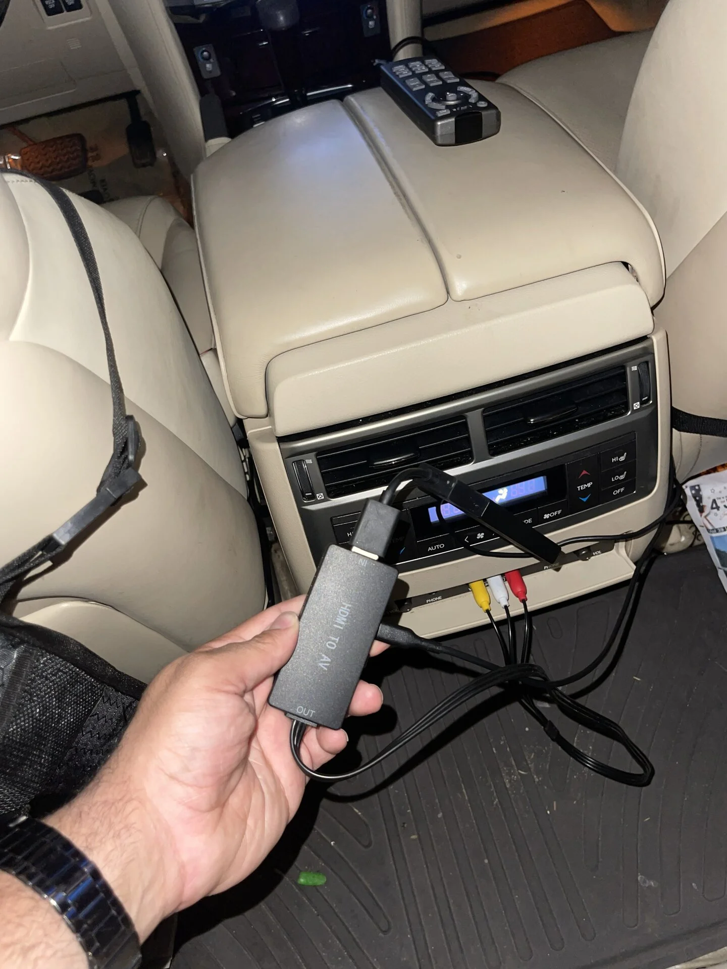

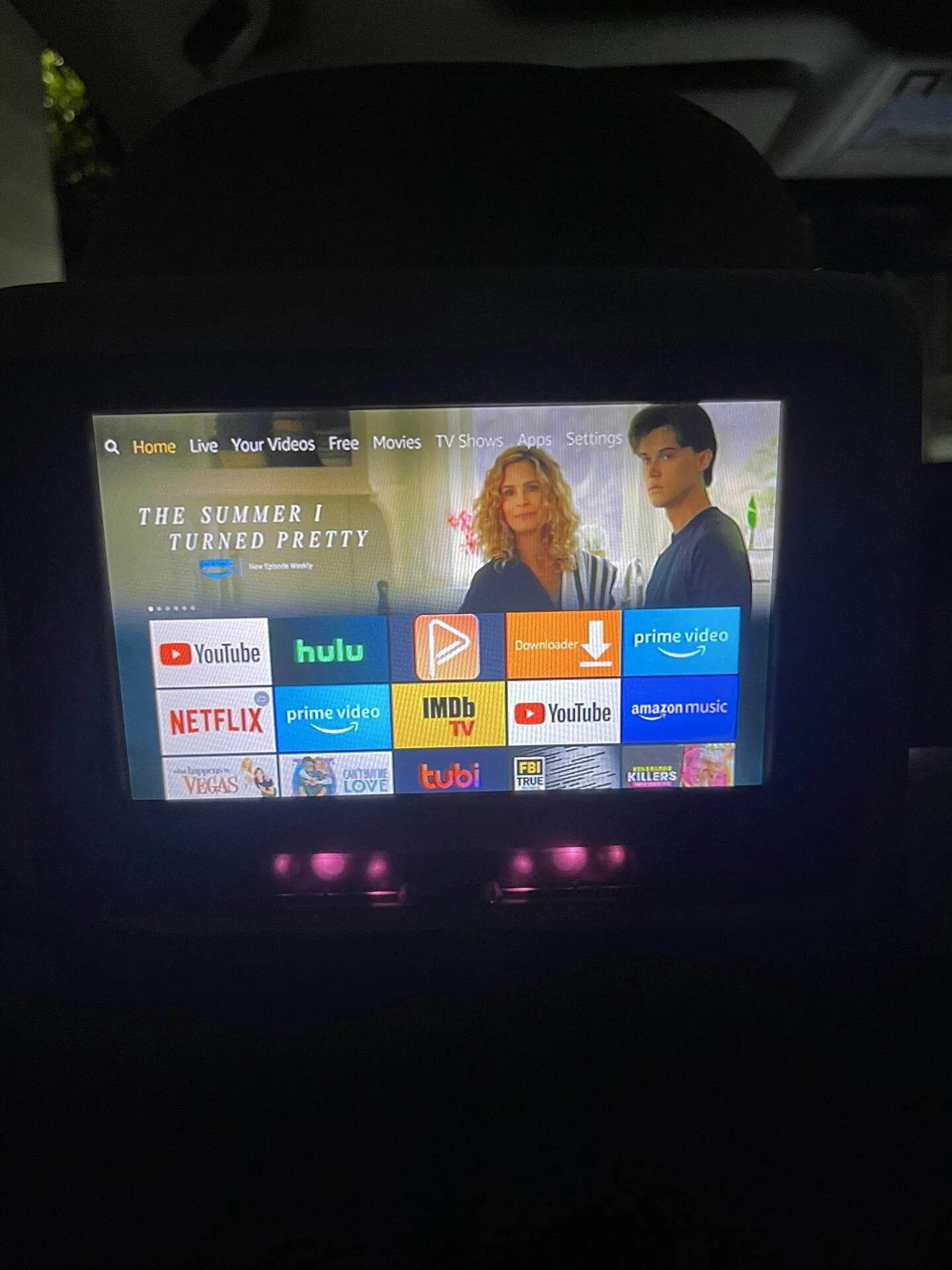

i finally found a solution for the rear screens, i bought a hdmi converter to rca, tried it and it worked perfectly with Amazon firestick (non 4K) now my kids can enjoy it. I also tried it was an ipad with usb c port and it mirrored the ipad without any issue.
