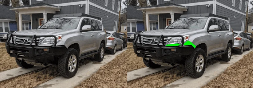

I am looking at getting the ARB bumper for my GX460. I am thinking the correct kit for this is 3421780. I see sold here:
What confuses me as I have not found a build thread using this bumper. How does one deal with the old plastic pieces in green? Does one cut up your old bumper for it or something else?
Very few are running the ARB bumper because there are very few of these bumpers available stateside. The most recent is on Overland1.0's build that was installed by Mainline Overland and they cut above and around the head light washers. The ARB sits closer to the body/grille than the Ironman version so it requires a more aggressive cut on the frontend plastics. Like those of us who did the Ironman bumper, you simply have to cut little by little as you go and find the right lines for your particular truck since these bumpers and their included stencils are designed for the 150 Prado frontend.

hah. this gx gets around. I took some pictures of the plastic bumper fitment: . It is all pretty floppy if you push on it, but it looks good.
I really like that setup, thank you. I don't know why I just love the ARBs. I have abused the one on my Tacoma.
