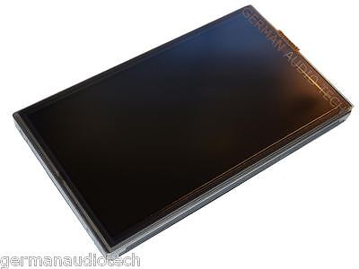

I was in the 200 market earlier this year and saw several higher-mileage LC's that had the screen yellowing, also delayed startup and touch inputs. The OEM part from Toyota is the entire NAV unit, which is $5000+. Didn't find much at all on Mud about the specific issue.
Had I gone with one of those, I would've attempted replacing the screen itself with this:
TOYOTA Land Cruiser 8 - https://www.germanaudiotech.com/products/toyota-land-cruiser-8-lcd-touch-screen-display-lta080b922f-navigation-lcd-lta080b922f
Curious if anyone has done this hardware swap successfully?
