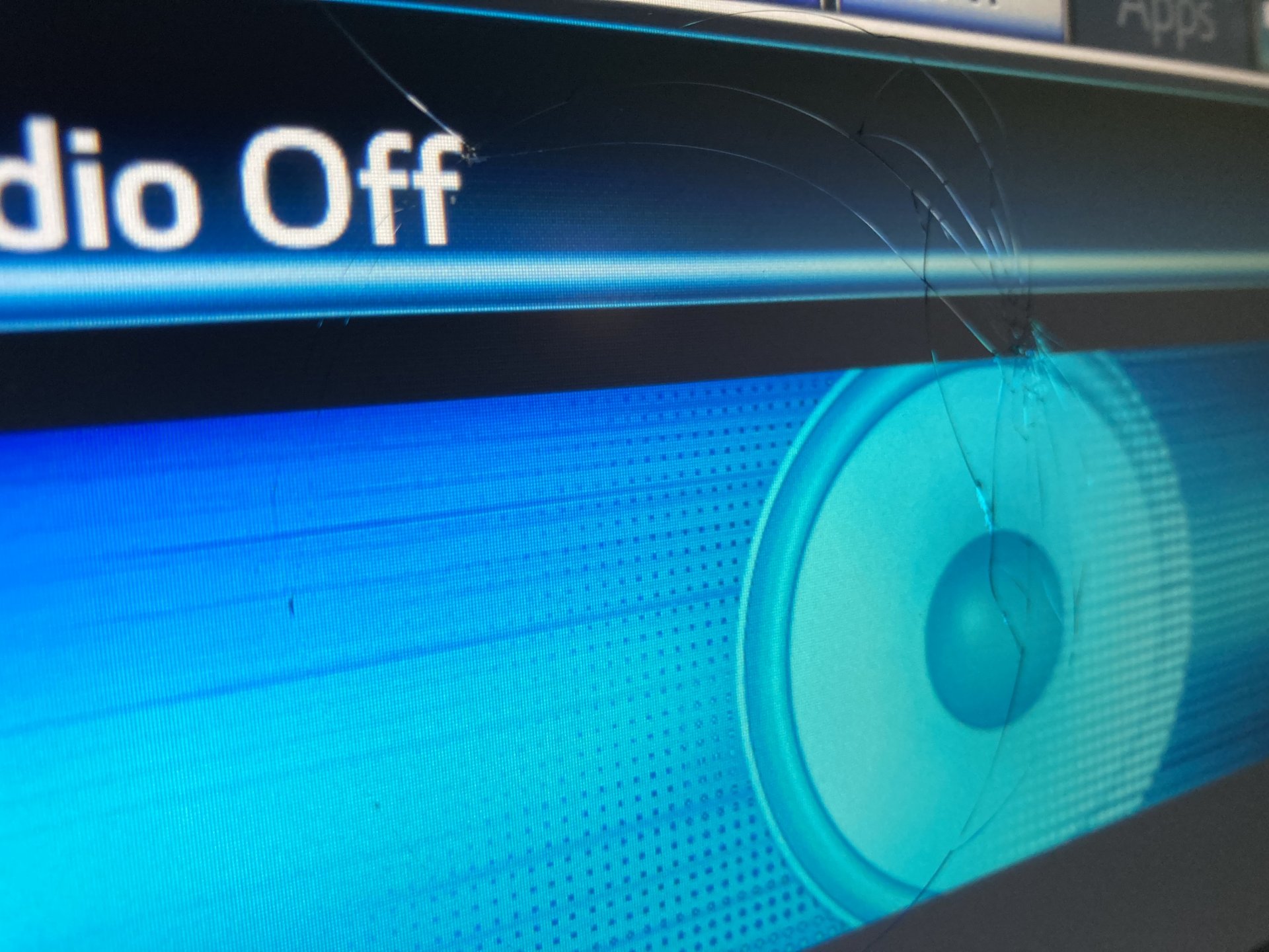

Managed to break my multifunction screen. 🤬
Jul 16, 2021
2
17
Wilton, ME
Trying to find somewhere to mount a phone holder, I stuck a suction mount to the screen(don’t do this)…..well, trying gently to pull the damn thing off, it happened….crrrrrrack…not gently enough it seems. It’s still mostly functional but has plenty of dead spots now. If I manage to find a used unit, are these plug and play or will it require dealer coding to make it work? Not sure of other options, searching shows the Tesla style kits but they seem to not work 100% with everything factory.
Vehicle in question is a 2014 LC
Thanks for any info!

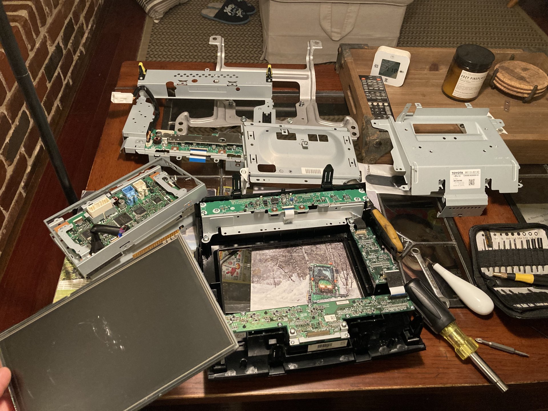

Well I decided to take it apart to get the part info on the screen. I haven’t been able to find the type that’s in there anywhere other than aliexpress and a couple of other random shops in China, so it’ll probably take several weeks to get one if I go that route, and they’re about $200, that’s for the lcd with the touch screen. I haven’t been able to find just the digitizer alone, the one I posted above isn’t like the one in mine. I’ll call some of these nav screen repair places next week and ask some questions, maybe they can get just the screen and install it. I went ahead and put it back together and reinstalled it. Happy it all still works, still broke but no worse off. And only two screws leftover!
I’ll update with any progress.
Thanks again for the tips!
