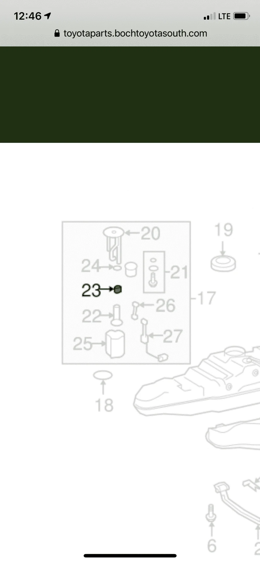

Well, I paid a visit to the shop yesterday and looked at the pump assembly on the bench with the techs. I figured out what they did wrong.
They didn’t transfer the spacer for the o-ring from the old pump. This allowed the o-ring to slide down the discharge nipple eventually unseating from the receptacle and losing fuel pressure. Gas was spraying back into the tank just as suspected. When the tech said the new pump didn’t look the same as the old one it all made sense. It didn’t look the same because they installed it without the spacer, which they thought was part of the old pump. I pulled up the parts fiche and showed them the missing piece.
It should be here Monday but I’m 99.9% sure this is the problem.
