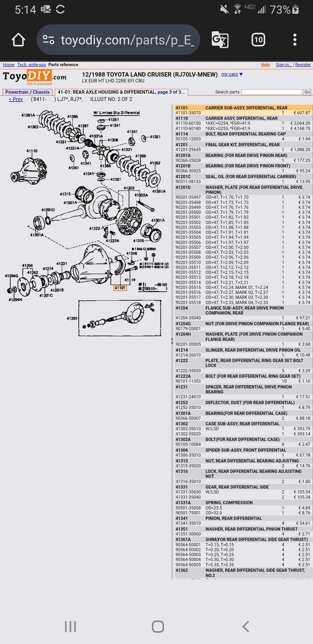

Toyodiy.com is showing different parts for the diff sub assembly. i would have to assume that means its 4.88 specific. looks like the other j70s use the standard part
