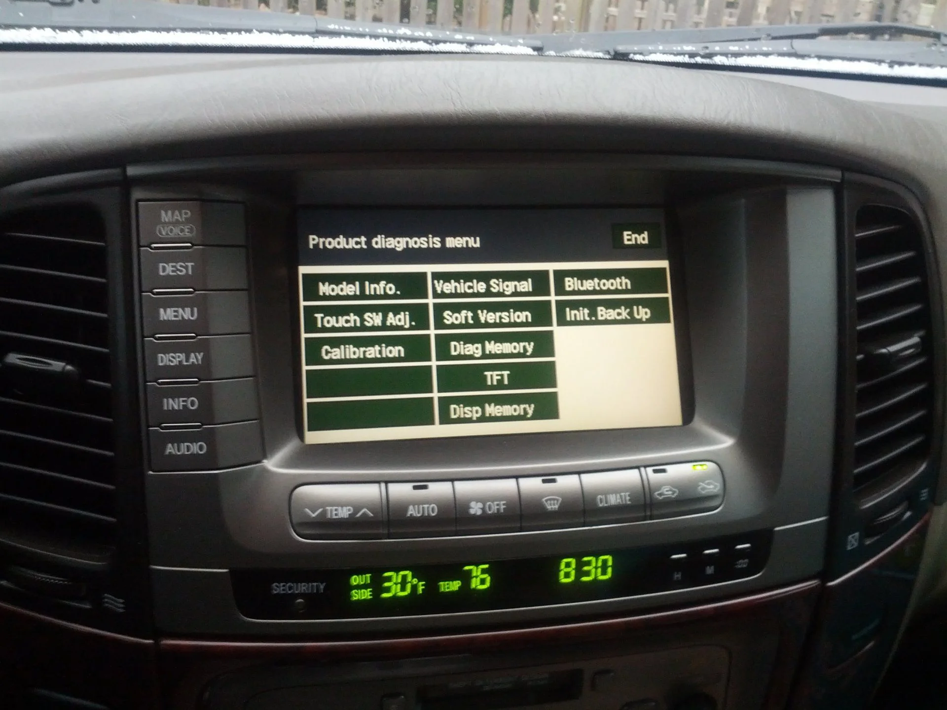

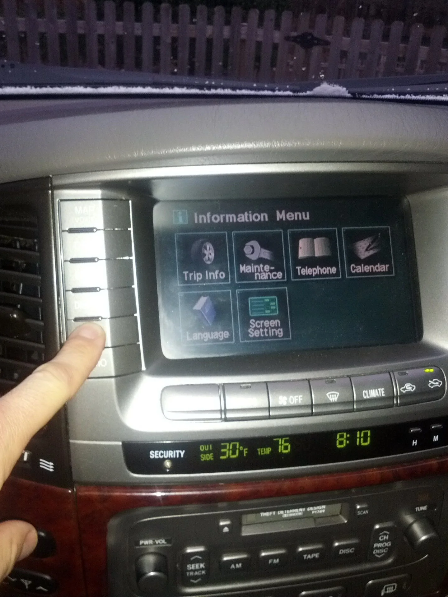

press menu to get back to the diagnostics screen.​
Then hold info again while turning lights on and off again.
Hopefully the buttons needed are accessible to you now.

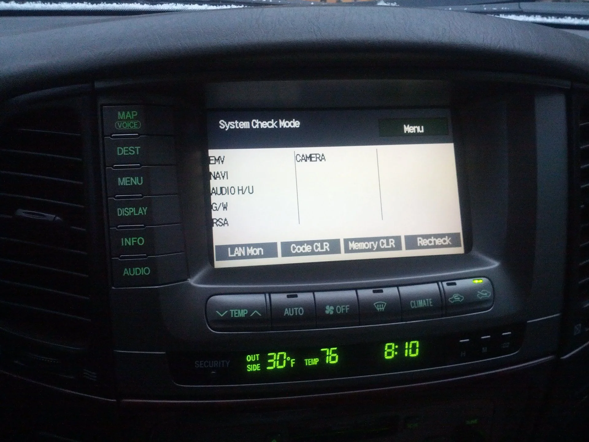

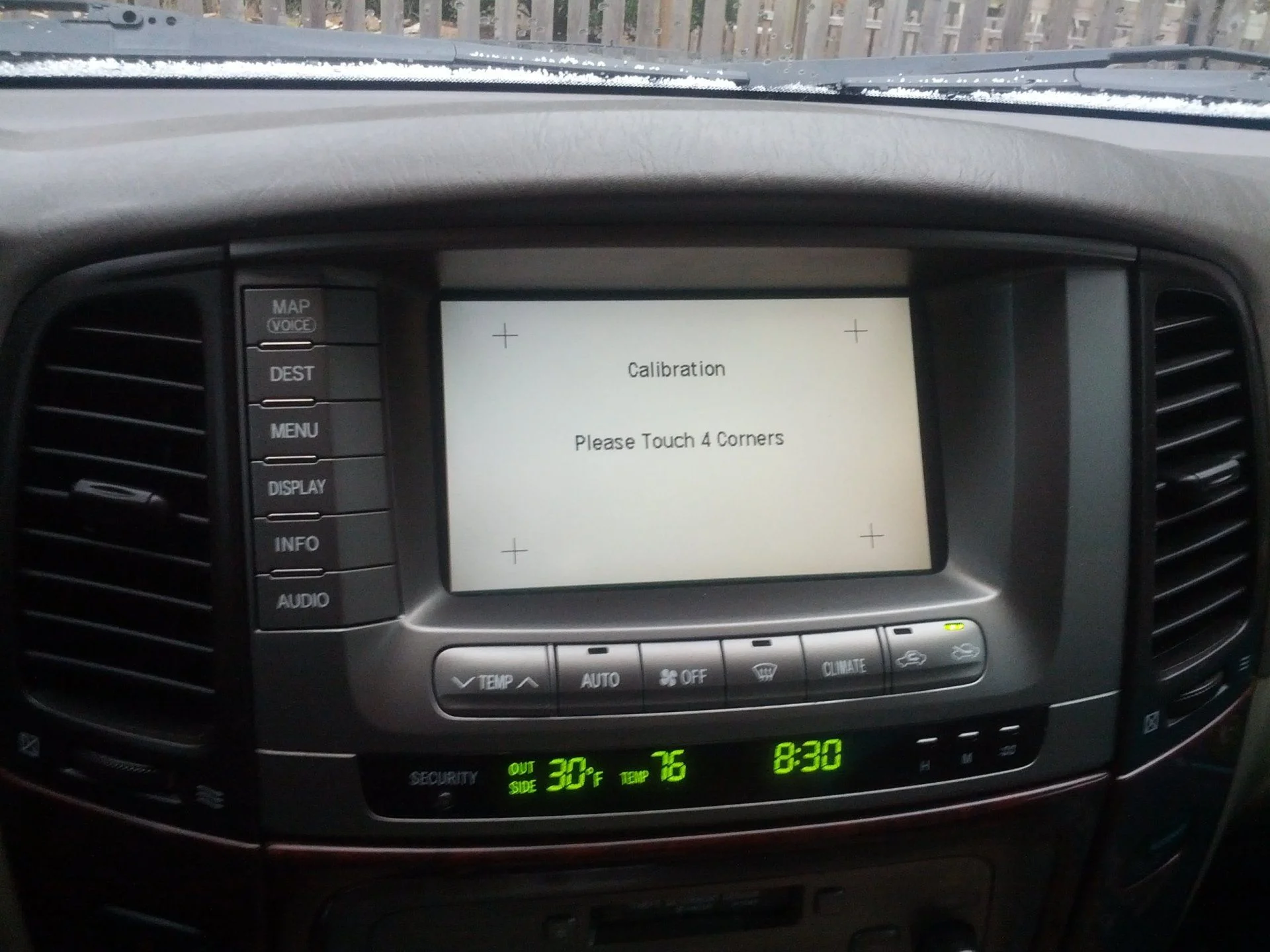

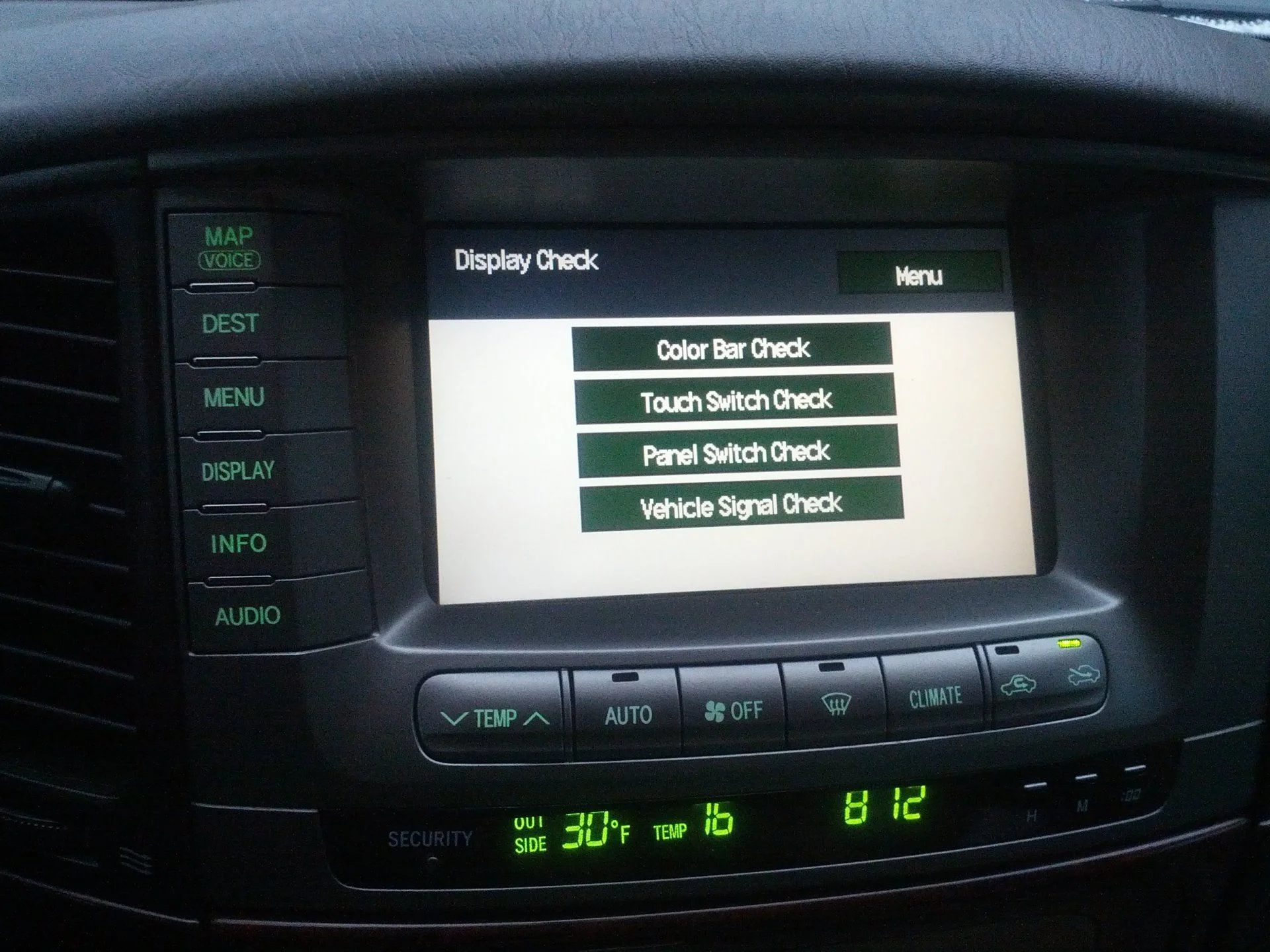

If you have an '03 (may work for an 04+ or earlier) you can put the system into "service check mode" by shorting Tc and E1 in DLC1 and then turn the ignition on. You get service/diagnostic access to the H/U, Nav and display and can view fault codes, check display alignment, switch functions etc. It's the same service screen that is pulled up by the "hold info button and turn parking lights on/off 3 times" procedure.
