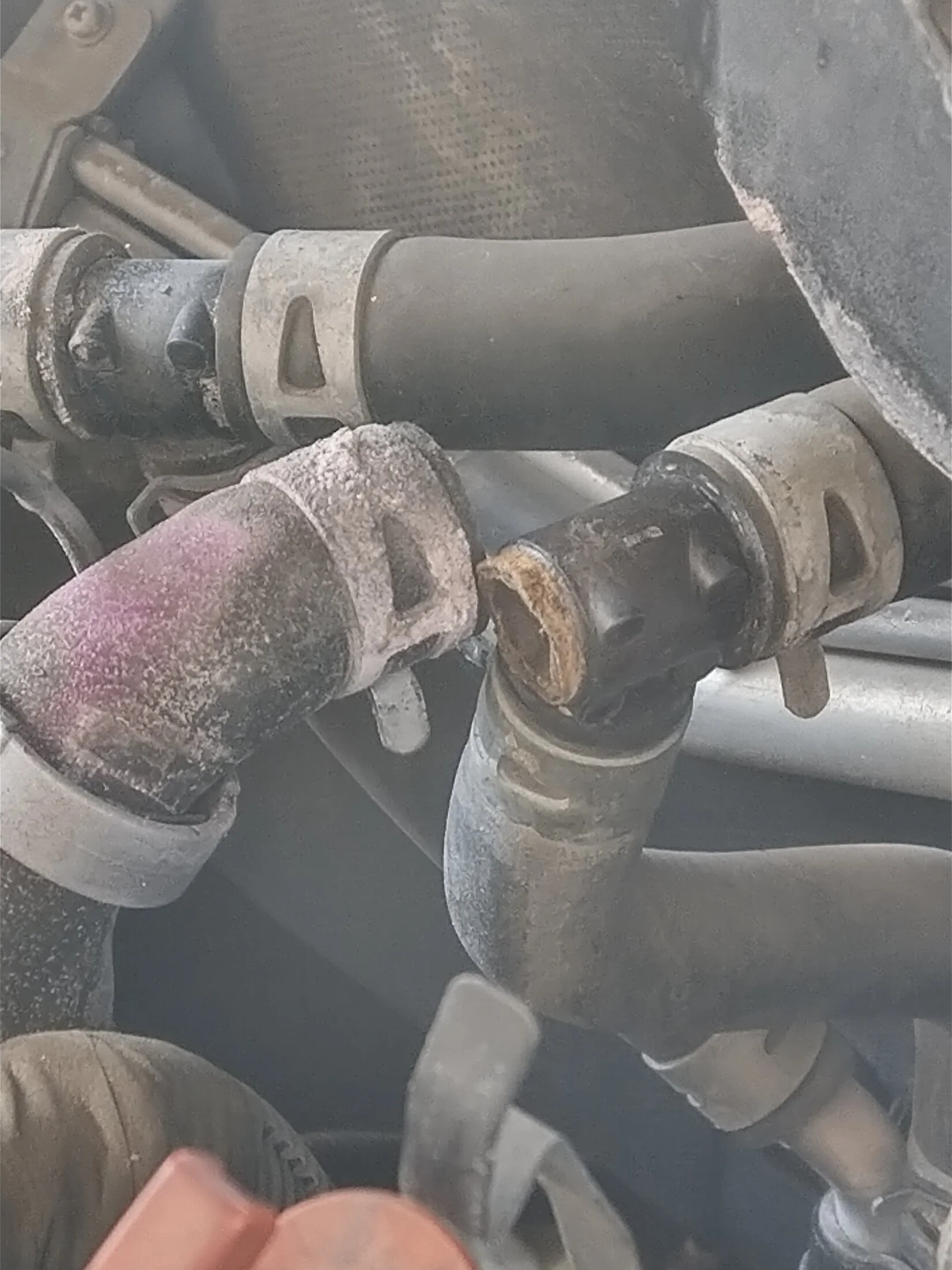

I was at the gas station when I noticed a large puddle of what looked like pink
coolant under the truck. I decided to go ahead and drive home since I was around the corner. I got home and looked under the hood and noticed the coolant reservoir was pretty much empty. I can't really tell where the leak is coming from but it seems to be coming from the hose with the pink residue. There's a few hoses in the area so I'm really not sure. Any help or direction would be appreciated.
Those are the infamous heater "T"s. It's likely that if you touch them you'll crack them in two or three pieces. I would replace them ASAP before driving the truck any more. If you do a search here you'll find lots of threads on i. You can replace it with OEM plastic Ts and be good for another 20 years, or upgrade to the metal ones sold by @cruiserpatch here: 2UZ-FE Heater Tee kit (OEM 87248-60460) - https://www.cruiserpatch.com/products/100-series-metal-heater-tee-upgrade-kit?srsltid=AfmBOooXS-cBSx3QAaZ2uX2zZQ0vGlmhsUYUAwUbwcEPPYarc8TvIxH1
Go do some reading on the heater tees. Yours likely need to be replaced. Make sure you burp the system properly when refilling.
Seems to be coming from the heater T's. There seems to be some discoloration from the other in the image as well. Have the heater T's & hoses been replaced?

Thanks a bunch. Im going to stick with the plastic ones since it's OEM. Didn't think something so small could do that much damage.

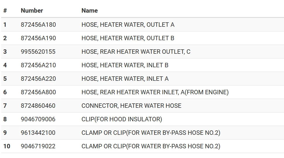

Thank you for this list. Neither have been replaced but i plan on replacing the hoses as well.

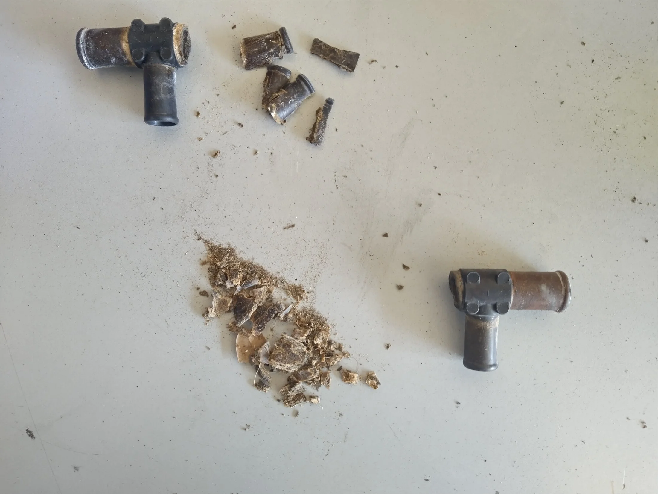

I just wanted to chime in to personally say thank you to everyone who helped me with this issue which definitely was the Heater "T"s. Pictures attached below for reference. One of them had already broke completely from the hose and the other one broke when removing the other hose. I was able to scrape the remaining pieces out after removing both hoses. I'm currently doing my first flush with distilled water and no leaks to report. I had to put about 3 1/3 gallons of water in so it looks like I'll need to purchase 2 more gallons of coolant. I'm confident I'll be back rolling in a couple of days. Thanks again everyone! This forum is really cool. 😎
